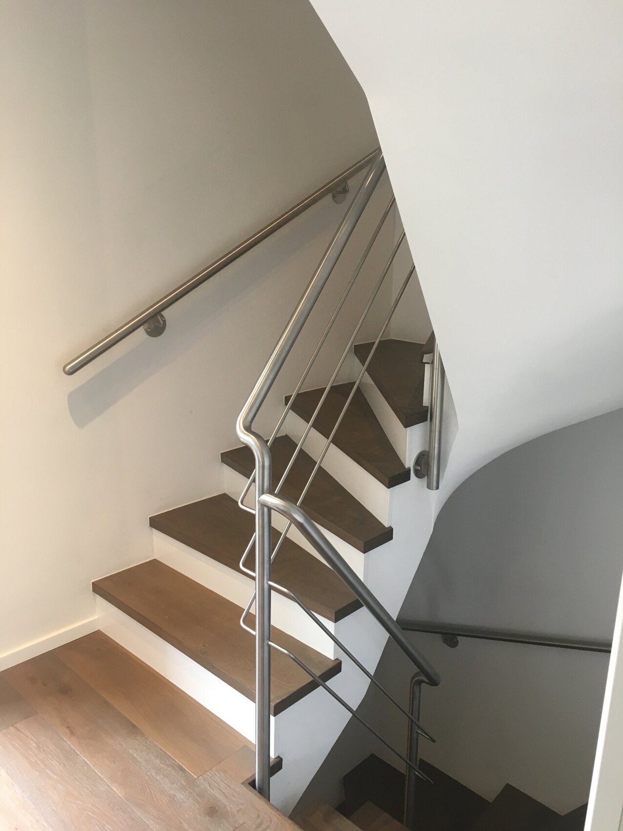

Good evening,
At the beginning of this year, we bought a house that was already completely renovated (lucky find). However, with a child likely on the way, the idea of an "open staircase" is no longer an option. I’ve attached some photos of the current situation and look forward to your suggestions.
My current idea is:
Installing an additional stainless steel rod between the stairs, connected to the upper corner with a safety glass panel. Then, a small wooden gate would be added at the top and towards the basement as a fall protection.
What do you think of this, and do you have any idea what the cost might be?
I’m also interested in how you would solve this problem.

DTvomHaus5 Jan 2018 22:01Thank you for your opinions and ideas. I will call the metalworker who installed the railings on Monday. The fall height is indeed quite high, which is why we want a permanent solution. However, I also find the wall-to-wall solution very interesting, especially since there is enough space for it. I will get some quotes.

DTvomHaus21 Jun 2018 12:42Unfortunately, in many threads, after questions and proposed solutions, no final results are ever shared. I want to change that at least a little:
Our solution was to retrofit a stainless steel railing. (For the initial situation, see the beginning of the thread) It has three metal rods on top because the uneven stair layout would otherwise have left a very large gap. The remaining gaps will be creatively covered with straps, cloths, or nets for the time "while the child is small." At the bottom, we will install temporary wooden gates. The railing cost about €2000 (around $2200), which I find reasonable: two people working a full day (about 9 hours each), plus preparation and materials...
