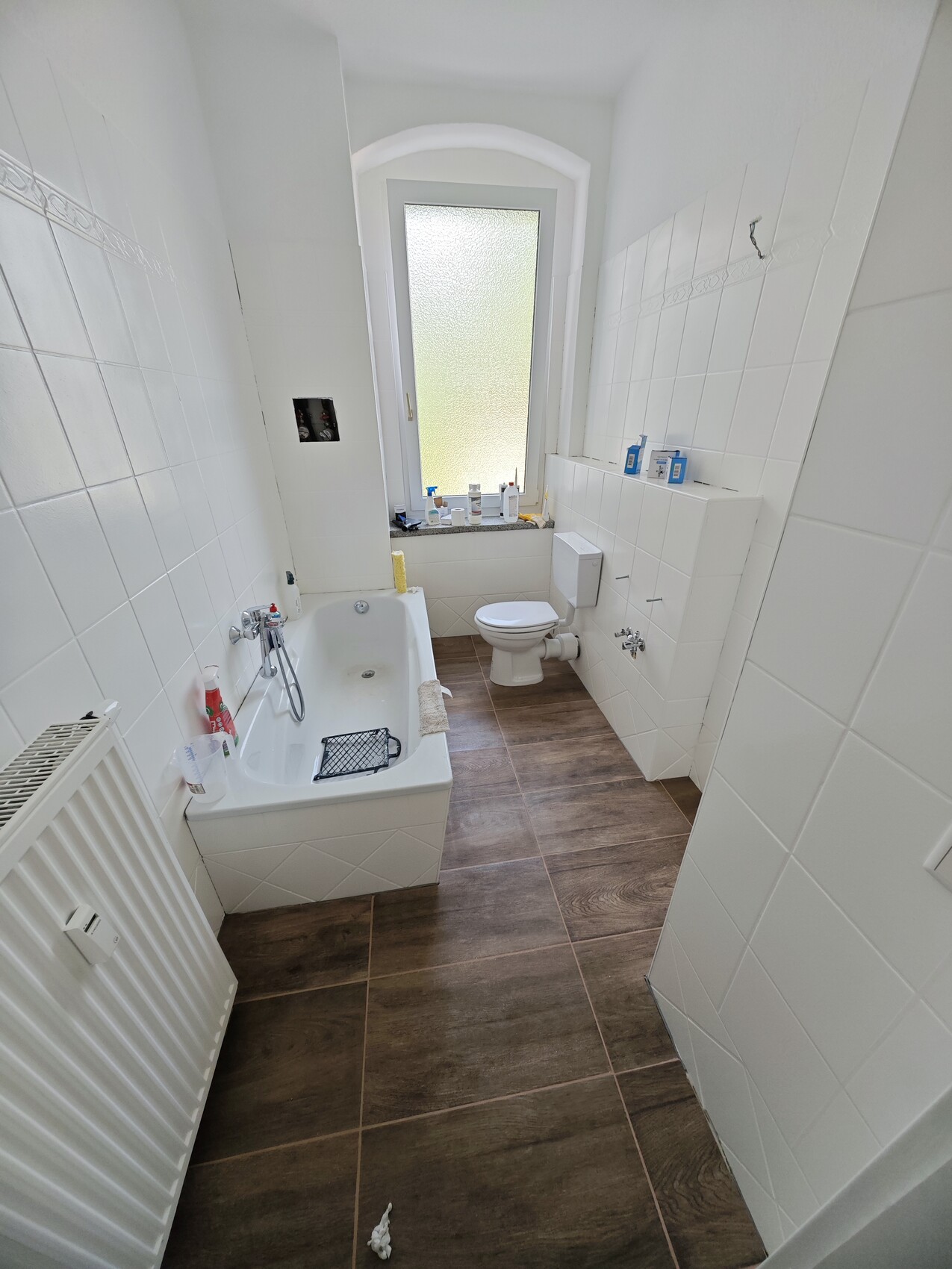

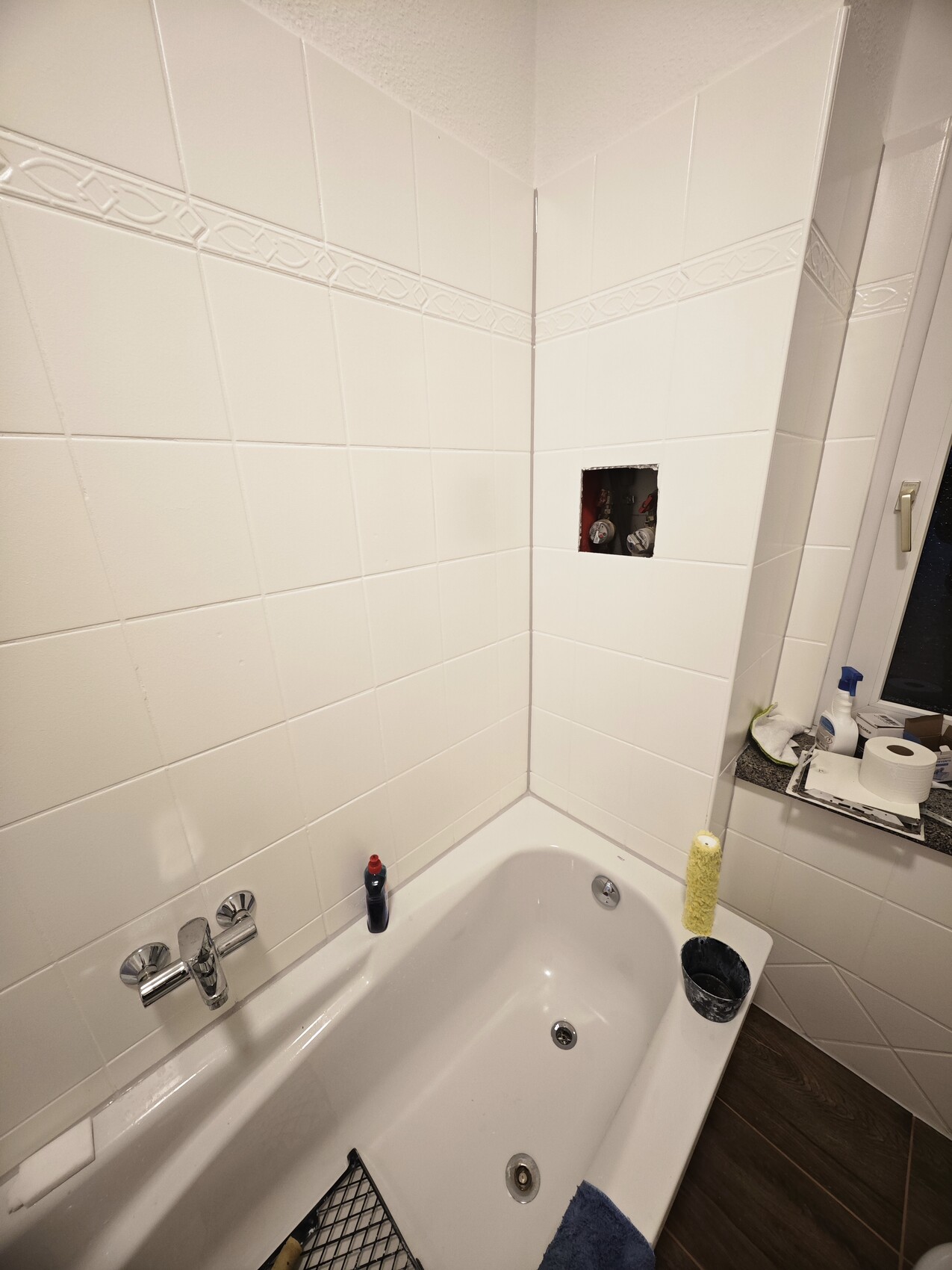

Hello!
I’m currently renovating a small bathroom. So far, it only has a bathtub, but I would like to add a shower option within the tub. Unfortunately, there are a few challenges...
The wall where the shower would ideally be installed has an access panel – and it doesn’t extend across the entire width of the bathtub.
Adding to the difficulty, the toilet is located directly opposite the bathtub. A permanently fixed wall right at the edge of the bathtub would be somewhat inconvenient.
Do you have any good suggestions other than a shower curtain?
Photos are attached.
Many thanks!

DReffects2 Dec 2024 08:29
Thanks for the input. What exactly are you looking for? I only found two- or at most three-part partitions, but nothing that could be customized individually.
Schorsch_baut schrieb:
Just like in the pictures. There are different models available.
Thanks, but that would only work at the bathroom entrance. I wanted to avoid that because visually, you would be facing a wall as soon as you enter, and the slope for lying down in the bathtub would also be there, which restricts standing.
