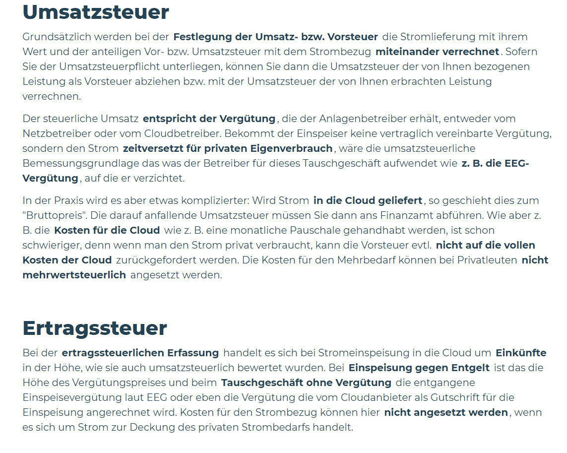

Regarding self-consumption again: Does that mean VAT must always be paid on self-consumption (about 4.5 cents/kWh, assuming 24 cents/kWh)? In other words, without the Cloud, self-consumption in the example above would be 4030 kWh (181 € tax), and with the Cloud 6530 kWh (293 €)?

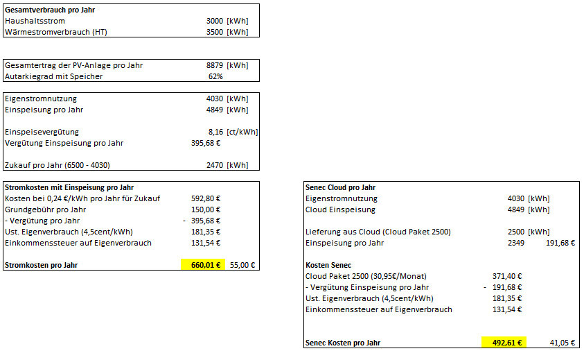

hippjoha schrieb:
I am also facing the decision between cloud service or feed-in tariff.
Here are some basic details:
Photovoltaic system: 9.8 kWp
Storage: 10 kWh
Orientation: South, roof angle 7°
Estimated annual yield: 8,880 kWh
Please, no discussions about the storage system itself ;-)
If I calculate with these values and an assumed self-sufficiency rate of 62%, the Senec Cloud is significantly cheaper. Am I making a mistake in my thinking or calculations? (see attachment)
Regards and thanks
[ATTACH alt="stromcloud-vs-einspeiseverguetung-465251-1.png"]56363[/ATTACH]Hello,Calculations involving heat pumps are always a bit different from what solar installers’ tools can compute. I will get back to that later, as I have modified a calculation tool that includes hourly consumption, battery charge status, and photovoltaic yield to also reflect the high winter consumption of the heat pump.
Do you have a separate meter for the heat pump? That would significantly change the calculation (heat pump tariff around 20 cents/kWh, meter usually about 5 €/month, heat pump cloud package with SENEC for 5 €/month + 7.5 cents/kWh for kWh “stored” in the cloud).

Do you have a separate heat pump meter? That would significantly change the calculation (heat pump tariff about 20 cents/kWh, meter usually around 5 €/month, heat pump cloud package at SENEC for 5 €/month + 7.5 cents/kWh for the kWh "stored" in the cloud).Okay, that would be interesting. No, a separate heat pump meter is currently not planned. I have adjusted my previous calculation to include VAT and income tax for self-consumption:
Is the advantage still with the cloud?!

The advantage would still be with the cloud?! Are there additional costs included for the cloud connection? For me, it was about 700 € (around 750 USD) for SENEC, and it would have been similar with E.ON. That comes to 35 € (about 37 USD) per year.
VAT and income tax are the same. Is that correct? I am not very clear yet regarding the cloud.
The heat pump tariff I have is 20 cents/kWh plus 60 € (around 65 USD) per year for the second meter. That would be around -300 € (about -325 USD) per year at 3500 kWh. The household electricity tariff would continue to have the option for free tariff switching in the future.
