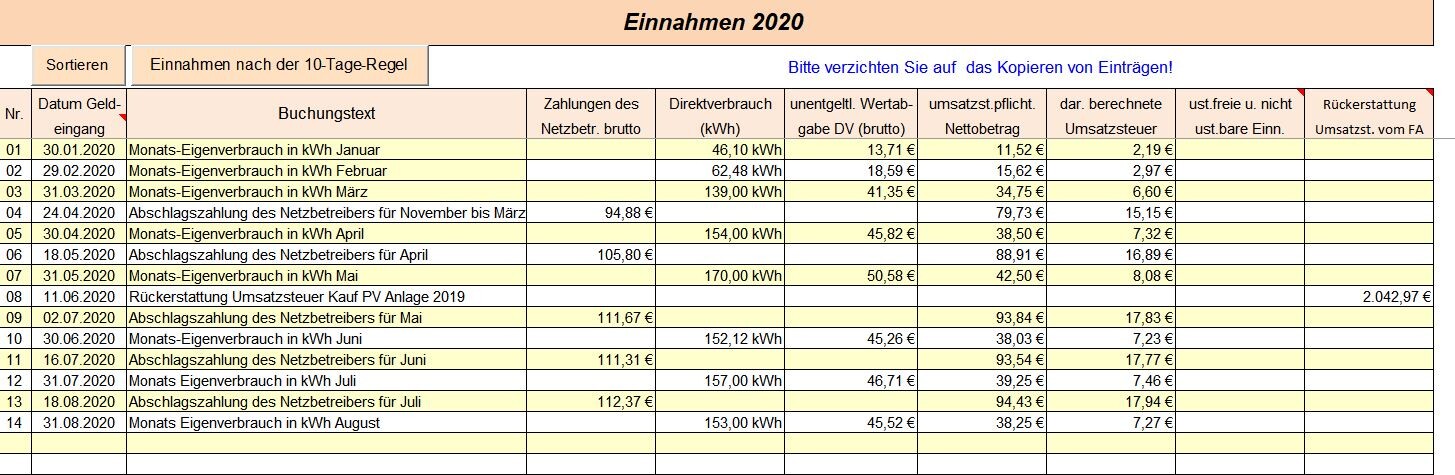

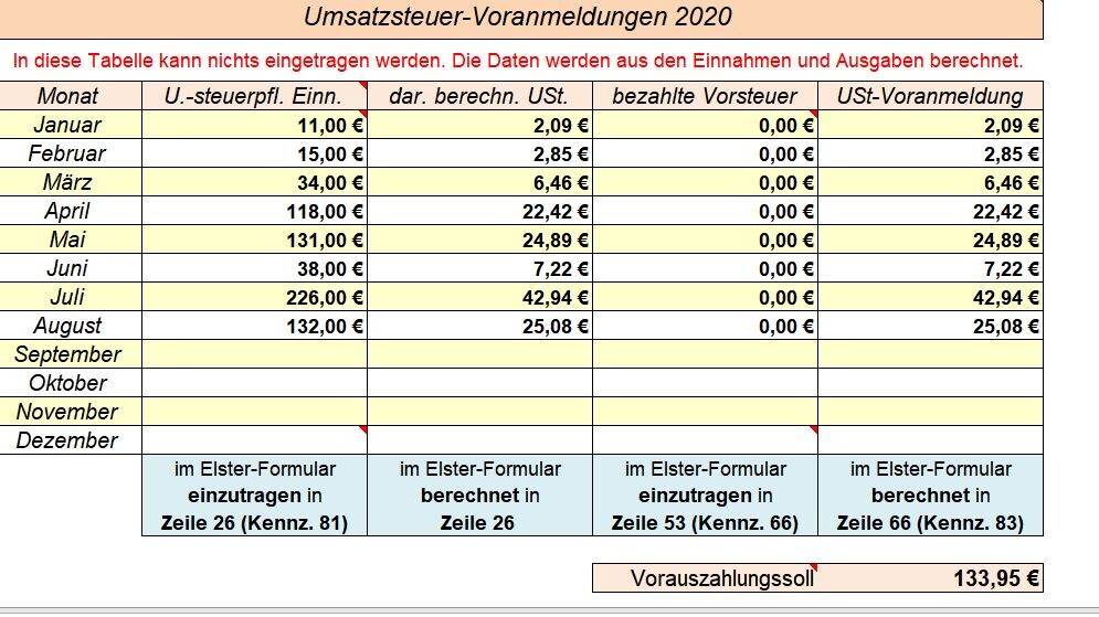

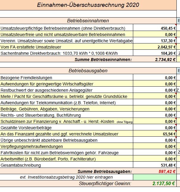

I have had a photovoltaic system on my roof for one year now, 8.96 kWp.
I receive about 100 euros feed-in remuneration and only have electricity costs of about 30-40 euros.
However, I still have to submit a monthly VAT advance return. You pay VAT on the feed-in remuneration and also an imputed supply tax on the direct consumption.
Then you also have to file an annual VAT return. You have to do a profit and loss statement (P&L) as well. The profit is then included in your personal income tax return as additional income.
Better read up on the whole tax topic first. This is not easy for laypersons.
Here are some data. You will have to get familiar with this as well.
