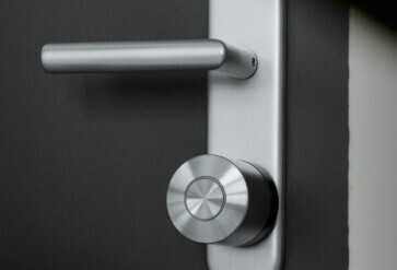

Bold Elite SX33:
- The exterior knob is free-spinning. By activating it via smartphone or a clicker, the knob is engaged and you can lock or unlock. This extends battery life significantly
- If someone doesn’t have a smartphone, they can lock and unlock with the clicker
- Battery lasts about 2 years (and apparently even longer depending on use)

With Bold, I don’t see this option. But you could give the children a clicker. If they lose it, you can simply deactivate it. This isn’t as problematic as losing a key.

- Bold: Activates the door lock, but you have to manually turn it to open.
