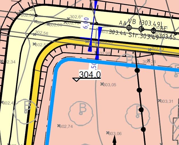

That was the plan... However, I noticed something while measuring the plot myself with a ruler on the digital survey plan: The planned street is at an elevation of 303.49, which is at least 50cm (20 inches) higher than the plot level.

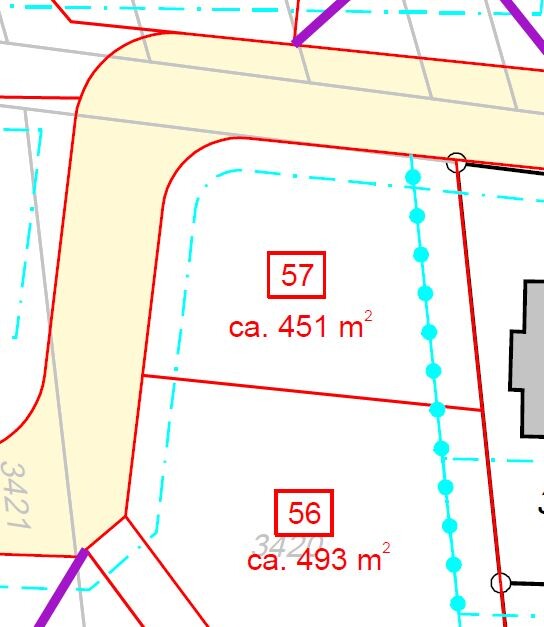

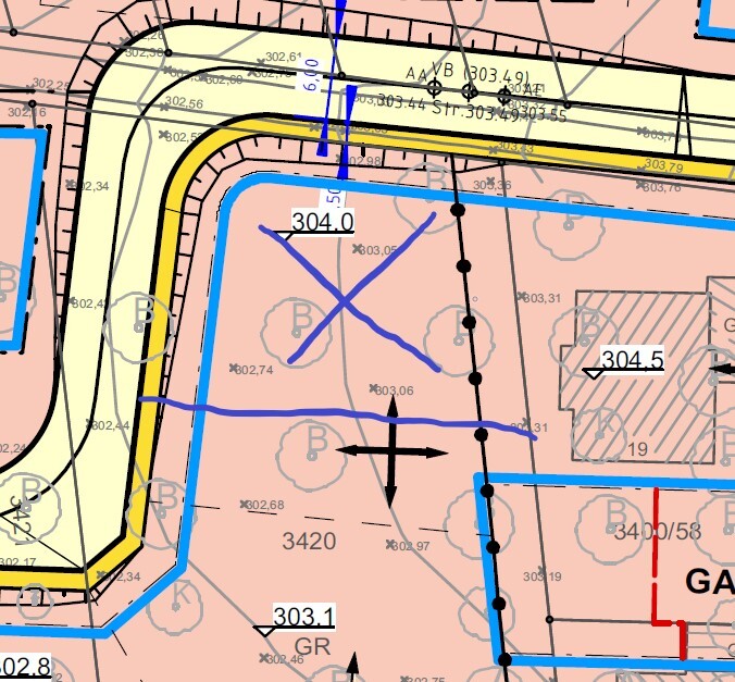

I’ve attached a section of the plot (including stipulated and planned contour lines).

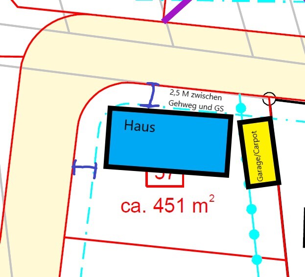

I quickly sketched how it should look (house and garage are not to scale. House = approx. 8 × 12 m (26 × 39 ft) and garage max. 3 × 9 m (10 × 30 ft) plus any additional width that is possible in the end). We want to position the house as far north as possible and place the garage along the property boundary. There is a 2.5 m (8 ft) setback from the street in front of both the house and the garage. The slope from the street to the property is about 50 cm (20 inches). The contour lines can be found in the planning permission (BB) image.
@11ant
The contour lines indicate the boundaries between different floor space index requirements and, in this case, also align with the building zone.
