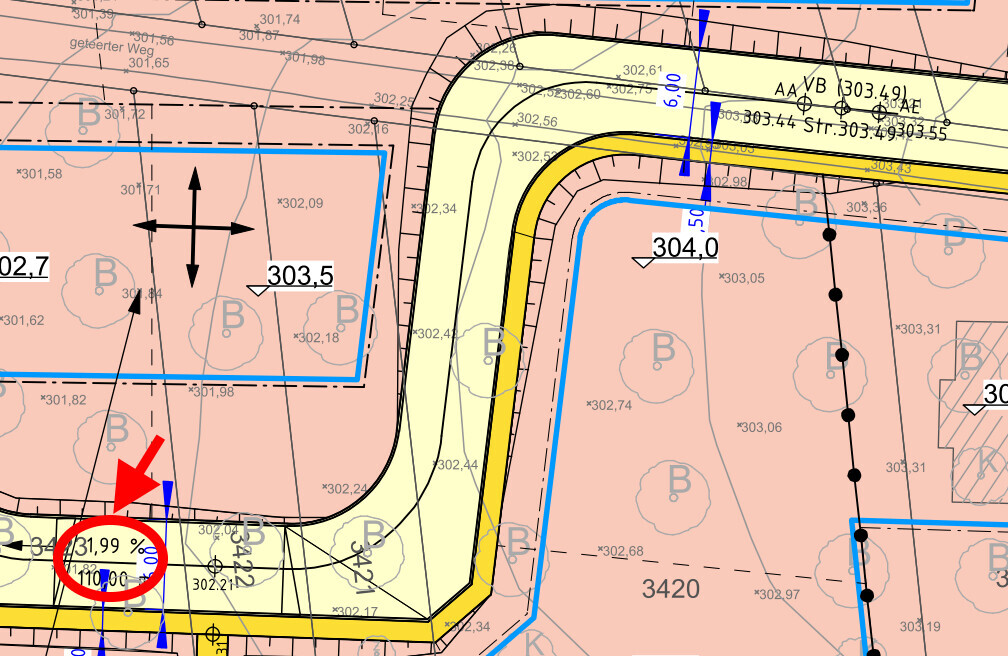

That was the plan... However, I noticed something while measuring the plot myself with a ruler on the digital survey plan: The planned street is at an elevation of 303.49, which is at least 50cm (20 inches) higher than the plot level.

I’ve attached a section of the plot (including stipulated and planned contour lines).

Cadastral map showing plots, road edge, colored boundary and infrastructure markings
11ant18 Oct 2020 00:41
ValeolKB schrieb:
I have attached a section of the plot (including the required and planned contour lines).
Unfortunately, the plot boundaries and dimensions are missing – better tell me the name of the zoning plan so I can look it up myself in the original. As it is, this is not useful.

The planned road is at Visierbruch at 303.49 meters (997 feet), meaning at least 50 cm (20 inches) above the plot level.
However, that is also the highest point. After that, the road slopes down at 1.99%. Since the reference point is to be understood as the maximum height, I fully agree with the architect’s statement.

@Escroda
How did you identify the 1.99% now?

Road design with curves, arrows, elevation details, and construction zones (304.0/303.5).
