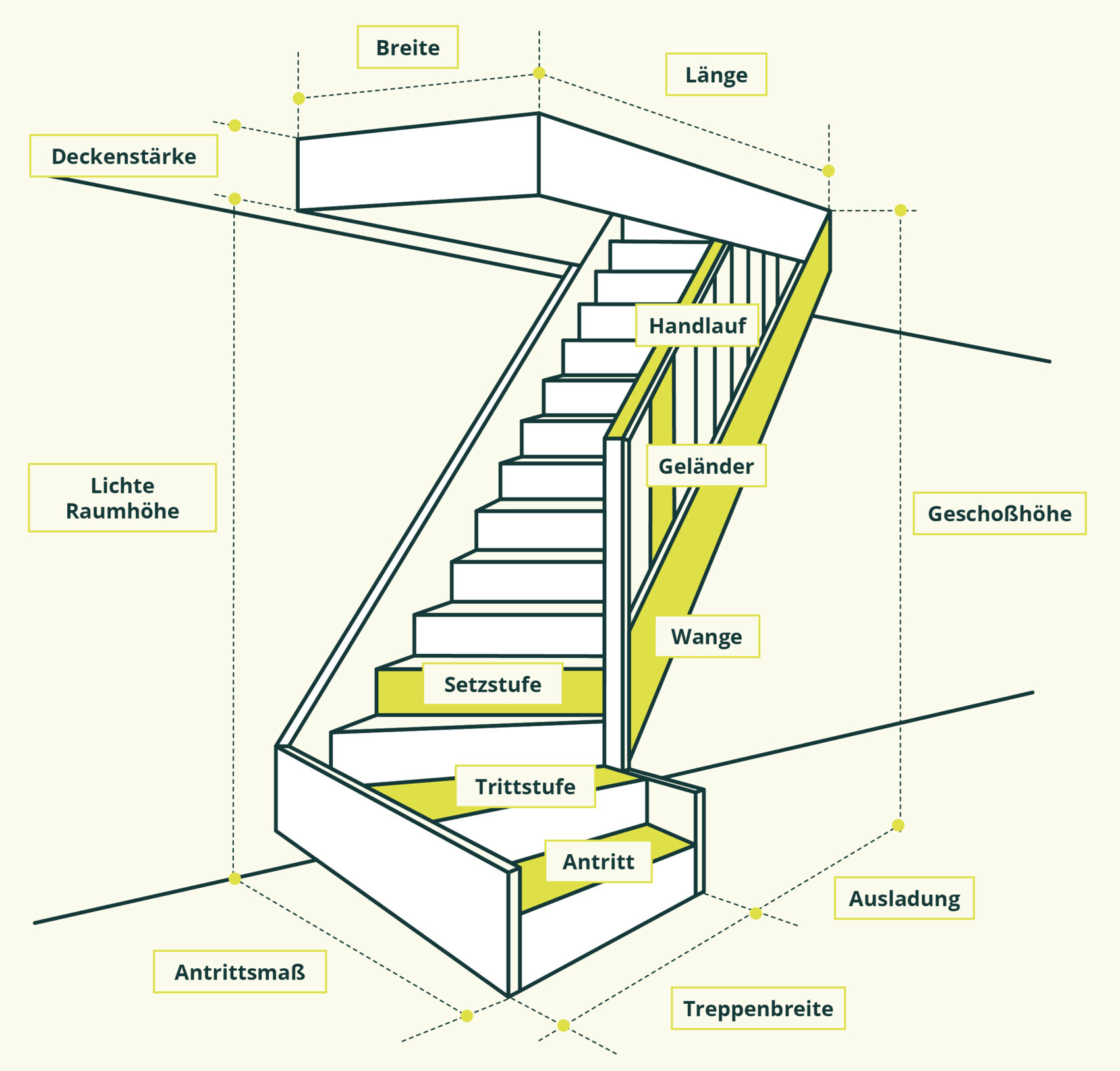

@ypg .. I have to disagree here 😉 .. according to Wikipedia, my understanding, and usage in various CAD programs:
The story height in buildings refers to the vertical distance between the finished floor surface of one story and the finished floor surface of the story above. The story height is the sum of the ceiling height plus the thickness of the floor structure above.
==> Stair height = story height; you just have to remember not to consider only the ceiling height.
EDIT: Nice image to illustrate
