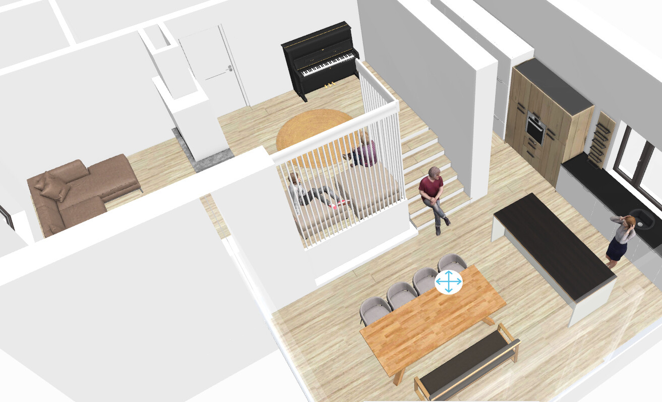

We are renovating a terraced house from the 1960s with split-level floors. Since we want to have direct access to the garden on one level, our architect recommended a single-story extension (entrance, cloakroom, kitchen, and dining room). From there, the first split level would be reached by 7 steps. This level would include the living room, toilet, and office. One exterior wall of the original house will be removed.
At first, I thought this would be really cool, like a gallery or split-level house. Now, I’m not sure if it might be inconvenient in everyday life. You enter the living room by going up 7 steps in the dining room. The wall will be removed to create an open layout.
I would really appreciate your opinions!

Unfortunately, the extension is taller than planned because the split-level design, meaning the living room, determines the height.
But honestly, this way it looks much cooler than with a 240cm (94 inches) ceiling height…

I’m interested in the wall I marked here with clinker bricks. That should be the old exterior wall, right? What materials does it consist of (plaster, clinker brick)? What’s behind it in the lower section? Basement? Or nothing? Maybe wall niches could be installed at eye level here? For example, for shoe cabinets?
Open 3D interior space with kitchen, dining table, sofa, stairs and piano
Here’s another perspective.
I would actually keep the living and dining area roughly like this if it were mine. Unfortunately, this extension is higher than planned because the split-level, meaning the living room, determines the height here.
Thanks so much for the great 3D visualization. It really helps to picture it better. The lounge corner right next to the glass looks very cozy – great idea overall!
According to the architect, we could easily increase the extension height by 10–20cm (4–8 inches), since he planned the roof structure generously and it can be reduced. Going higher, meaning up to 2.80 or 3 meters (9.2 or 9.8 feet), is more complicated because we would need clearance approval from the city. It might be possible, but we are still considering whether to do it. We would like to install tall cabinets all the way from the wardrobe to the kitchen as suggested here. Floor-to-ceiling cabinets – would that look good with a ceiling height of 2.60 or 3 meters (8.5 or 9.8 feet)?

K a t j a30 Oct 2025 05:27
Unfortunately, the extension here is higher than planned because the split-level design, meaning the living room, sets the height.
dbertig schrieb:
Wow, thanks for the great 3D visualization. It really helps to get a better sense of it. The lounge area right next to the glass looks very cozy, simply a great idea!
Many thanks to Yvonne.
I’m afraid the visualization is a bit misleading due to the missing ceiling. The opening to the lounge area at the base of the living room is only 1.25 m (4 feet) wide. Then the extension’s ceiling follows. There are also two columns. This means that from below, you mostly just see the legs of the people in the living room. Hmm, I wonder how that will look?
