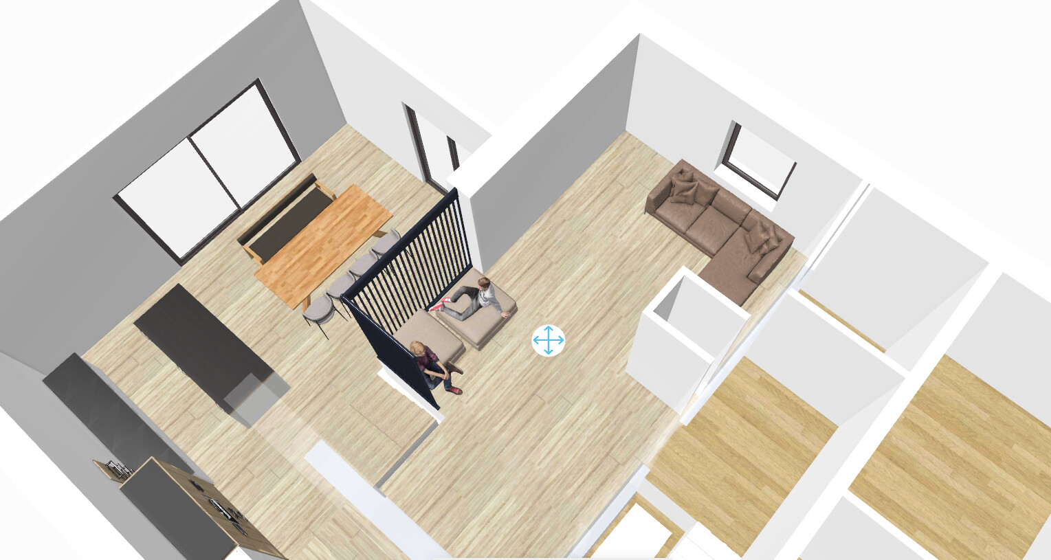

Something like this. Quick & dirty once again:
Open 3D living area with kitchen, dining table, sofa, and partition on light wooden floor.

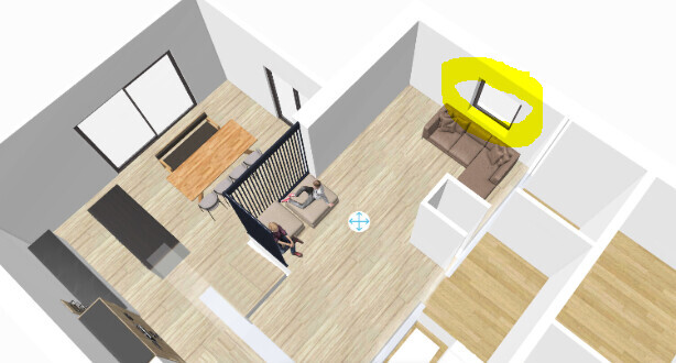

Sorry, I still don’t understand: why does the window in the living room have to be bricked up in the top left corner of the plan?

I think the idea of having a bench (preferably a wide upholstered bench) on the upper floor at the “divider” is better. A window seat isn’t really comfortable. It would probably be too warm on the south side. I’m also not sure if I would change the terrace door facing south. You can, but it’s not necessary.
A window seat, if there is one, is nice for short-term fun and some sliding fun. If you have poles as a divider, the kids can also enjoy them. And honestly: why should the kids stay in the dining area when they can play or watch TV upstairs for a few more minutes?
Something like that. Quick & dirty again:
Wow, thank you so much for the great visualization! It looks really cool! Which program did you use for this? I’d love to learn SketchUp :-)
You’re right, you could create a cozy seating area up here. It looks really good. I just had some concerns that it might partially block the view to the stove and the rest of the room.

Sorry, I still don’t understand: why does the window in the living room need to be bricked up in the upper left corner according to the plan?

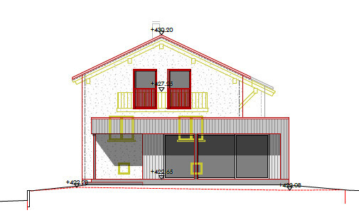

Unfortunately, the window cannot remain because the extension goes exactly through that window. You can see it marked in yellow (everything yellow is the existing structure and will be removed):
Modern front view of a single-family house with terrace, balcony, and large windows

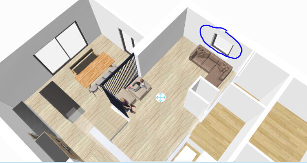

The other window facing west will remain and will be enlarged (blue):  <br />
