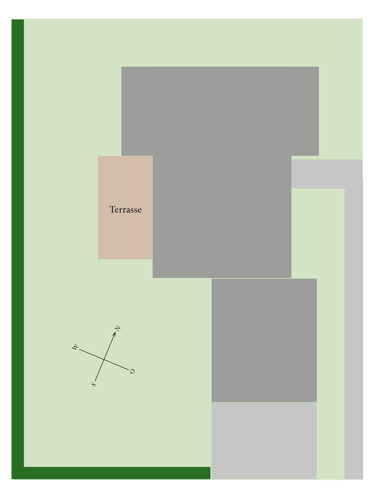

I would consider separating the garage from the house and positioning the house lengthwise at the back. In my opinion, this creates a better garden layout and a nice spot for a covered, sheltered terrace. I would then lead the access path rather along the right side of the garage, so that the mail carrier and unexpected visitors don’t end up directly in the garden and on the terrace.

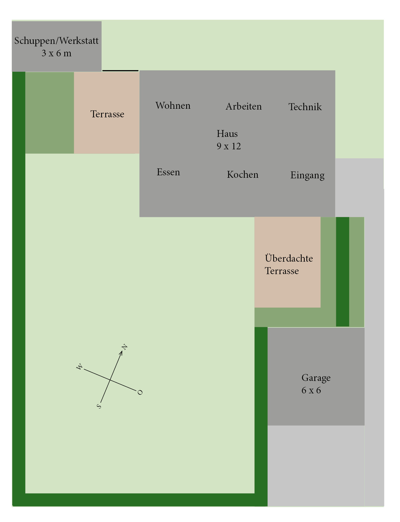

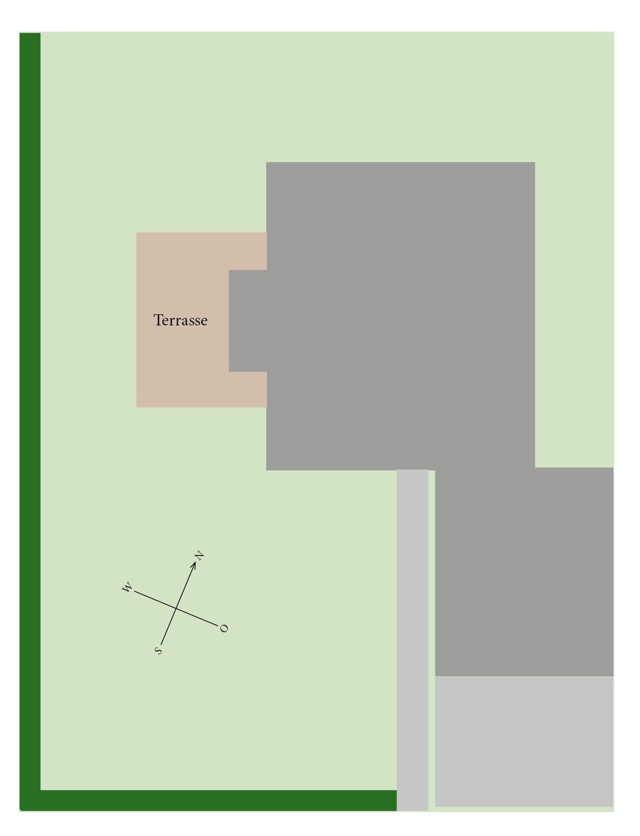

I initially drew your old proposal, now also the new one. This one is definitely better, but I still miss the orientation toward the south-facing garden. I would place a separate shed for a workshop in the northern part. That way, you also get some privacy screening there.
The dark green areas are meant to be hedges, the medium green represents flower beds, and the light green is lawn.
So, here is my new suggestion:
