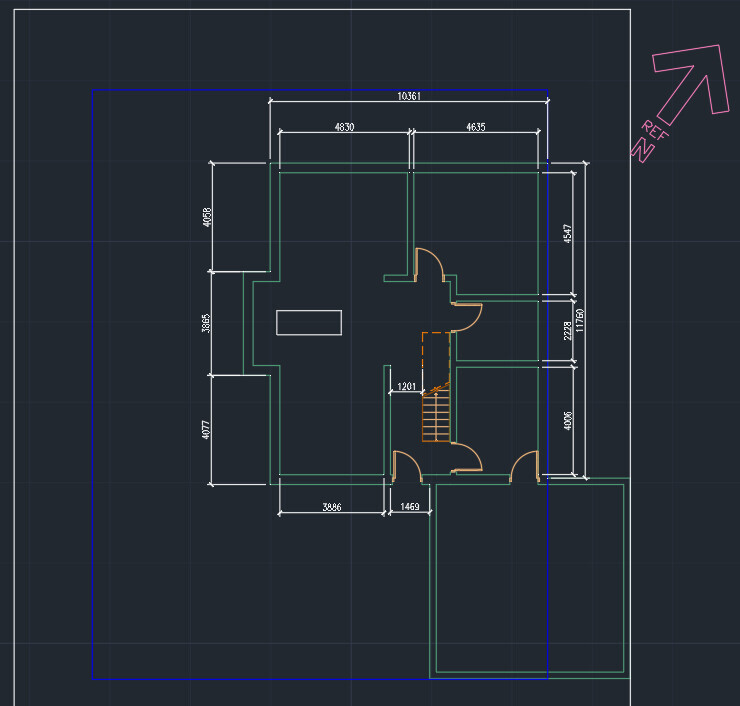

DeadlyWords11 Sep 2020 11:25@K1300S Yes, the granny flat is off the table; the space just doesn’t work out. I can quickly share two screenshots that clearly show our progress regarding two full floors. That would also give us more room for a possible larger garden/tool shed, and then I could use the garage space as a workshop. Although I work in IT/system electronics, I still enjoy doing things by hand. What we haven’t completely ruled out is the idea of having the washing machine and dryer upstairs. It all depends on the space on the ground floor, especially if the utility room really needs to accommodate a heat pump, ventilation system, fuse box with home automation, and a battery storage system. For now, it’s only about the floor plan; windows and such would come later once the rooms make sense. Some might say these things need to be coordinated together—I agree—but before I put in expensive corner windows in the dressing room and get a lot of negative feedback, I prefer to be more cautious at this stage. In this case, I would put the wardrobe under the stairs. Bottom left is the kitchen, above that the dining area, then the living space; upstairs right would be workspace/guest room, a toilet with shower, and technical room.
The blue lines mark the building boundaries, and the white outline shows the property boundary.
EDIT: @haydee That was just a bit sarcastic, but I wouldn’t hold it against you.
EDIT2: Boundary garages are allowed; I only have one question: what counts as a boundary garage? Would a small room attached to the back of the garage, or simply extra storage space, also be permitted?

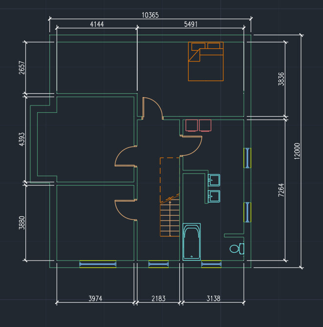

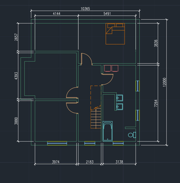

DeadlyWords11 Sep 2020 11:36I find the floor plans really difficult to read, not because of the colors but due to the somewhat confusing dimension lines. Could you maybe remove those? (The dimension chains can stay.) Otherwise, I’m missing the furniture layout and/or room labels.
By the way, I would place the washer and dryer more toward the back of the room, not right near the entrance. We have it like that as well—with a wall/door to the bathroom—and are happy with it.
Consider planning a small utility room on the upper floor. Include a sink and some storage space, for example, for suitcases, Christmas decorations, etc. All of this usually ends up in the music, hobby, or possibly second child’s room.
The entrance area is currently a bit small. There is no cloakroom.
