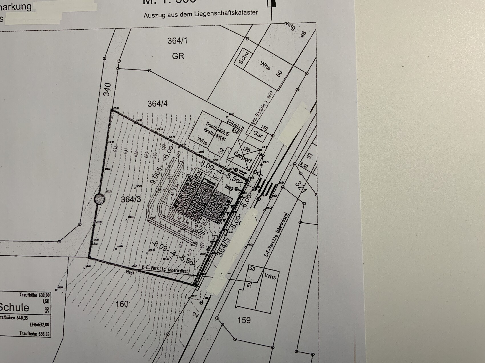

My wife (23) and I (27) bought a plot of land some time ago that we plan to build on in the next few years. We don’t have children yet, and since we are still quite young, the topic is still open, but we would like to include two children’s rooms in the plan.
The particular challenge of the plot is that it is located on a steep slope. The length along the building line is 34m (112 feet), and the depth in the middle is about 36m (118 feet). Over the entire depth, it rises approximately 12m (39 feet). Parallel to the building line, the road runs about 6m (20 feet) away. There is no zoning plan/building permit (planning permission), the building line must be adhered to, and the neighboring buildings are a single-family house and a multi-family house with different roof ridge directions. The lower part of the plot (where the building is planned) is somewhat flatter than the upper part.
The ground condition is partly rock (BK6), which is why my idea was to build only a half-basement. The intervention into the slope should be kept as small as possible, so I have imagined a narrow and long building volume. The first sketch ended up at about 7.5 x 14.5m (25 x 48 feet). A garage or carport is not planned; with a half-basement as in my sketch, I could also imagine using the "hobby" area as a carport with a suitable canopy.

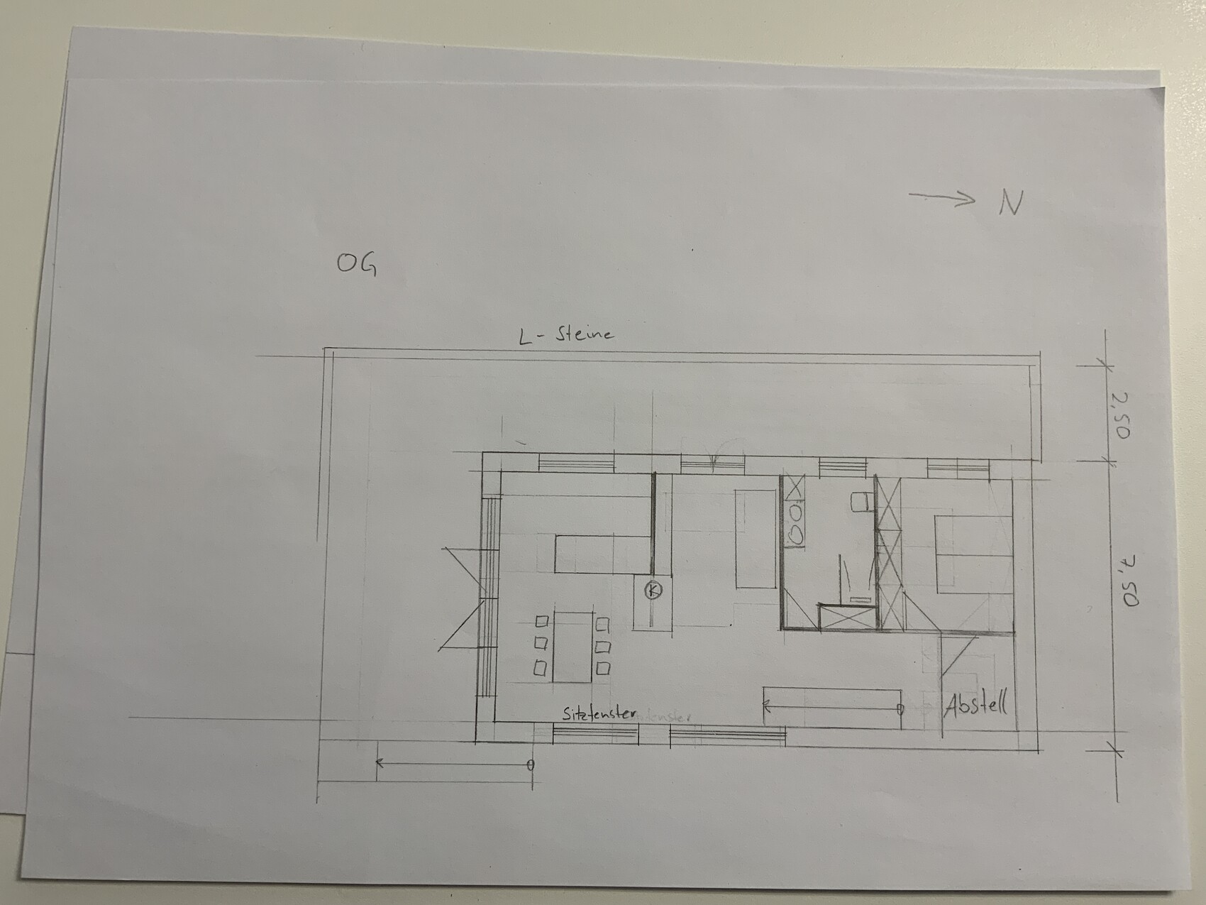

To the east is the valley; the view is quite decent, so the seating window is planned there in my sketch. To the south, there are trees and bushes, as this is the edge of the village with no further buildings.

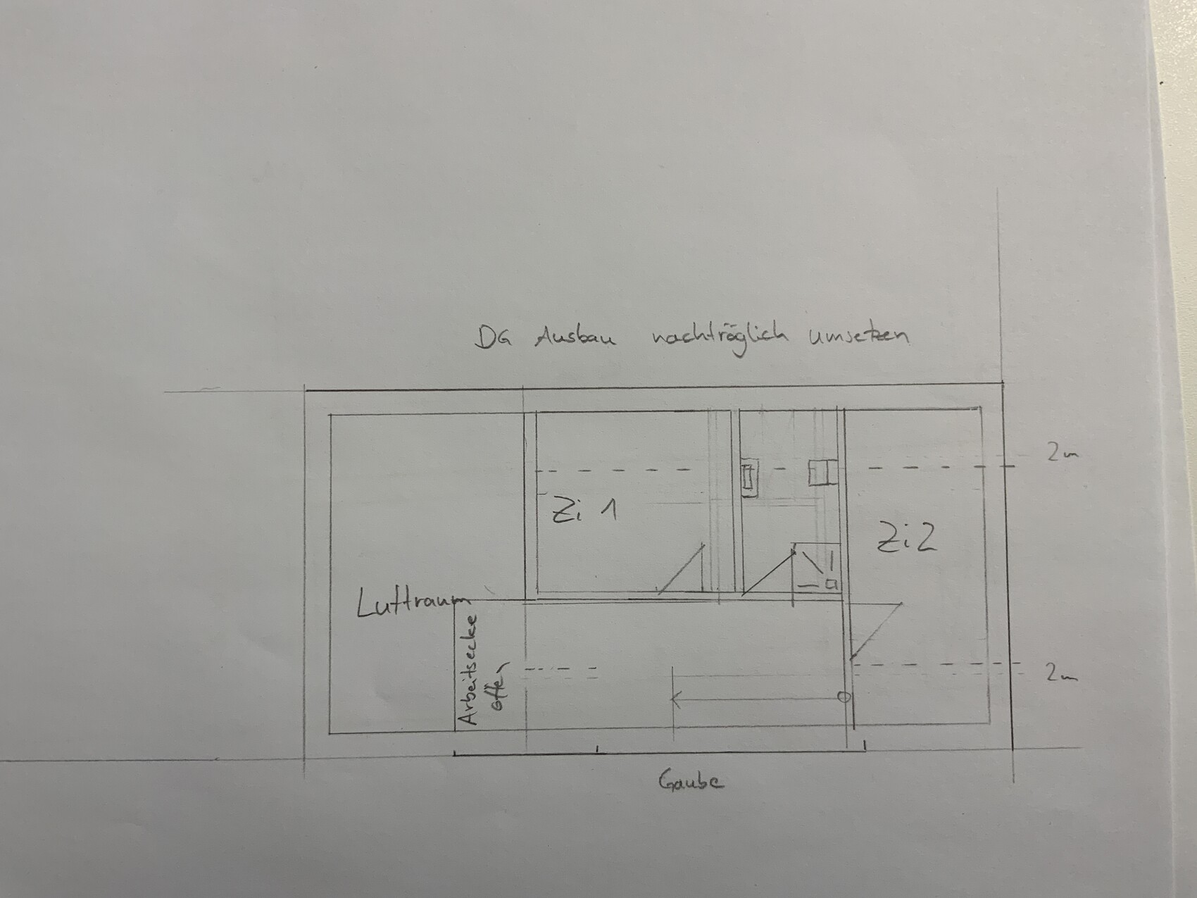

What do you not like? The staircase arrangement and the knee wall require a dormer; it would probably be simpler and cheaper to raise the knee wall to normal wall height and make the roof less steep.

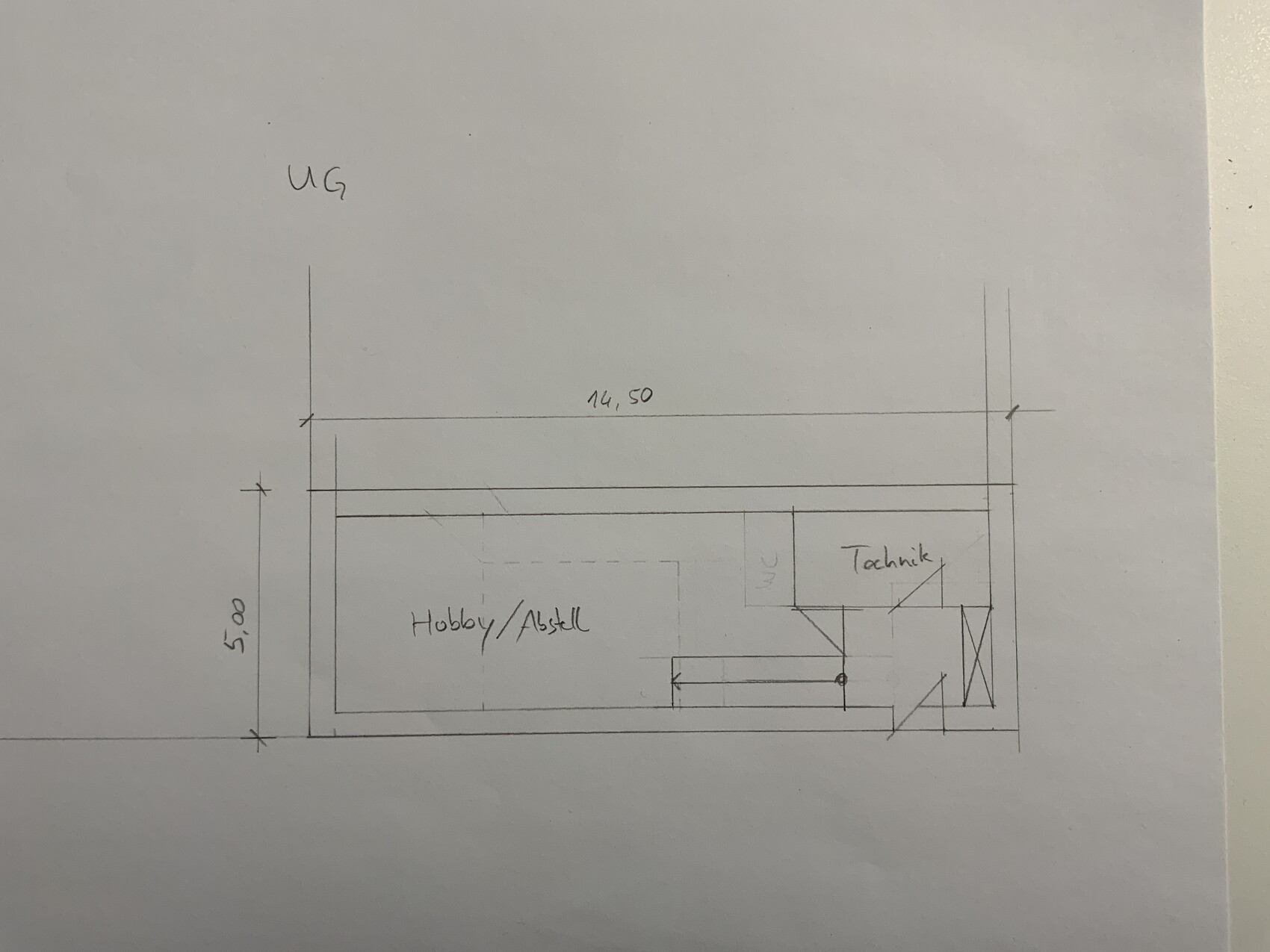

An alternative I could also imagine would be to omit the attic completely and install 2 children’s rooms in the basement.

I really don’t like the attic; either the stairs must be changed or the knee wall raised to 2m (6.6 feet). I like the stairs in the ground and basement floors.
The site plan shows the neighboring buildings and the steepness of the slope. The drawn plan was not implemented.
The sketch represents initial ideas and can be completely discarded. On the north side, no or hardly any windows should be planned. On the one hand, the neighboring house is close to the boundary; on the other, for energy reasons.
Please excuse the poor quality of the site plan; I can have a blank one without the old plan prepared next week.

I would plan the carport next to the house to manage the slope. Plan the outdoor area now. Think more as a family. Throughout the house, it feels like a young couple is building.
Plan the basement as living space and skip the attic. If possible, a full basement. Place building services, storage, and a workspace underground, with an entrance including a cloakroom (which you currently lack entirely). Upstairs, have the living area with open gables.
The technical layout looks very tight. Cloakroom is missing. The staircase seems too short; measurements are missing. Bedroom: where will a baby bassinet or crib go? Suitable for aging depends on design. You have a straight staircase; stairlifts are available. Bathroom: a bathtub is missing. Years ago, I almost moved in without a bathtub, but my father uses it for pain relief, and you won’t stay that young forever. I would also plan a guest toilet. The bathroom is private, and sometimes there are things you don’t want everyone to see. The living area feels somewhat narrow. There should be about 4m (13 feet) between the sofa and the TV.
The children’s rooms upstairs are small. Try furnishing them. I would consider placing them in the basement instead. Keep in mind that some children aged 6 still have restless sleep, come to their parents’ room, or have nightmares.
The sunken terrace in the outdoor area will be shaded. Plan a play area or pool area, a utility garden or barbecue spot, and a third terrace for sunbathing. Heavy machinery will be needed before the house is built.

Pitigliano7 Jan 2022 19:05ypg schrieb:
P.s. I've probably never seen a building plot with such a steep slope on a site planWell, it’s still manageable. I see 3m (10 feet) within the building envelope. That’s roughly the height of one story.Similar topics
