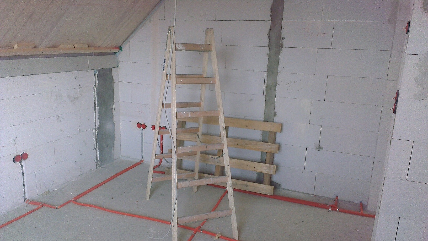

Hello, I’ve attached a picture to show how I imagine your issue. I suspect it was similar in our case, where steel supports were integrated into the walls at a few points and filled with concrete (in the picture, the dark vertical “line” at the back in the otherwise light wall).
So far (we have been living here for over 2 years) there have been no cracks at this spot. Although there is a relatively thick non-woven wallpaper and paint over the plaster, I just felt the surface and it seems there is no crack underneath. The indoor temperature hardly fluctuates throughout the year.
