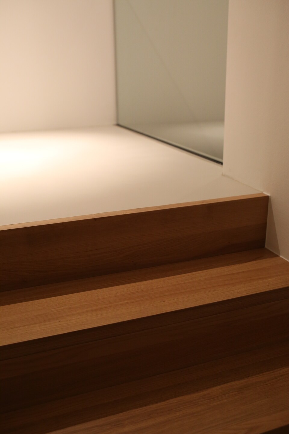

I know dozens of staircases from relatives, friends, and distant acquaintances after they have moved: I am not familiar with this kind of finishing step at all.
The last example looks very elegant. The cladding works better here than with a cantilevered staircase.
By the way, in our rental apartment we have a marble staircase, cantilevered, made from doubled and custom-cut countertops, with a polished stainless steel handrail, definitely costing well into five figures. Terribly extravagant, but the previous owner before our landlords was a bank director...
Even this luxury joiner doesn’t have such a finishing step. And honestly: the transition from marble to maple parquet flooring would look strange too.

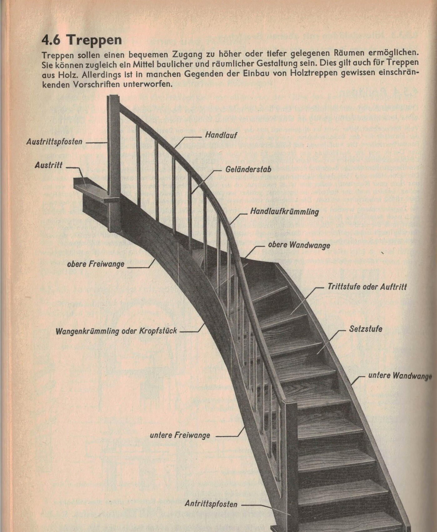

Since my experience is mainly with older buildings and wood plays a major role in our region, I can only speak for wooden staircases built in the traditional way. I have always considered the landing and stair end as standard components. It must be a heritage-related requirement. I’ll show you the illustration from a 1979 textbook. Of course, steel builders definitely have very different options than carpenters.
Gabriele
Schnittzeichnung einer gebogenen Holztreppe mit Geländer, Handlauf, Stufen und Pfosten.
