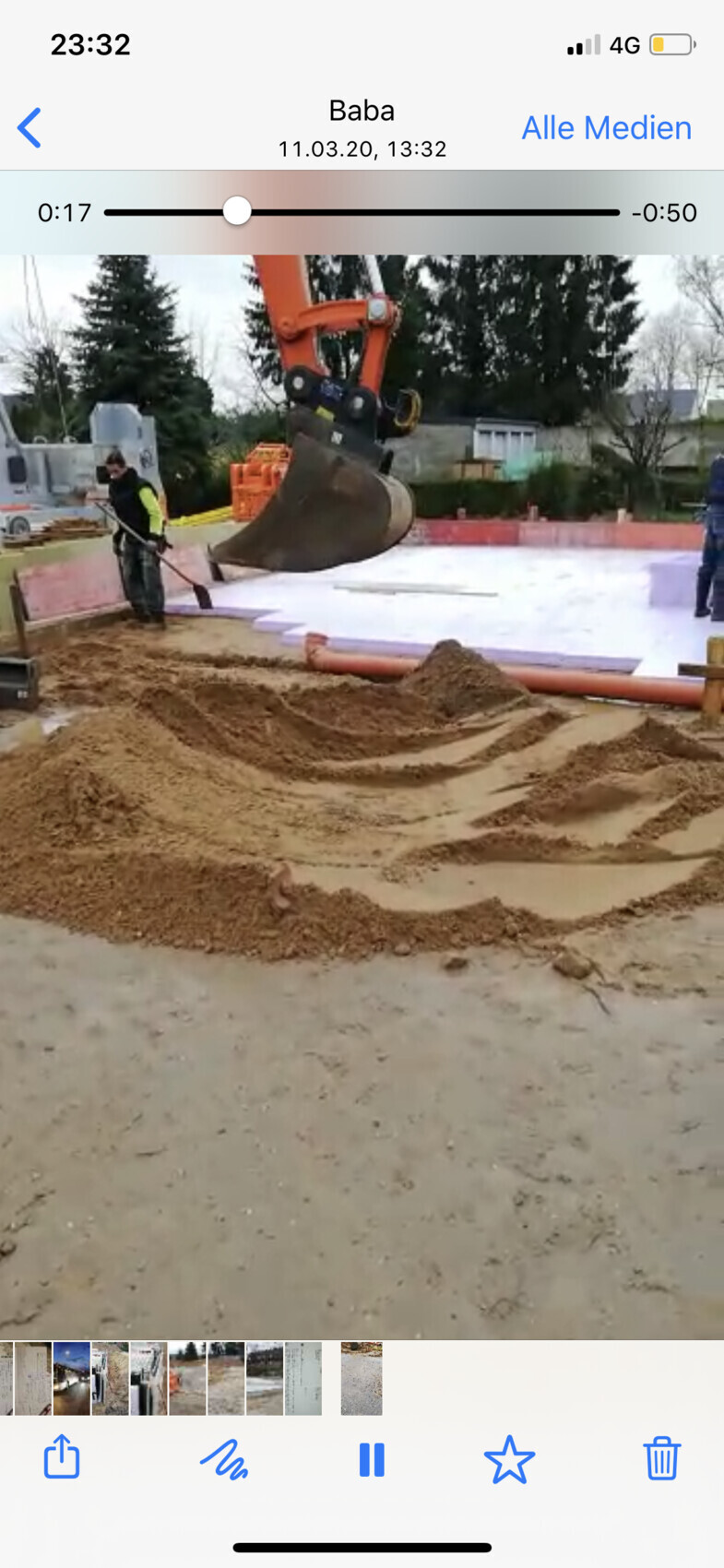

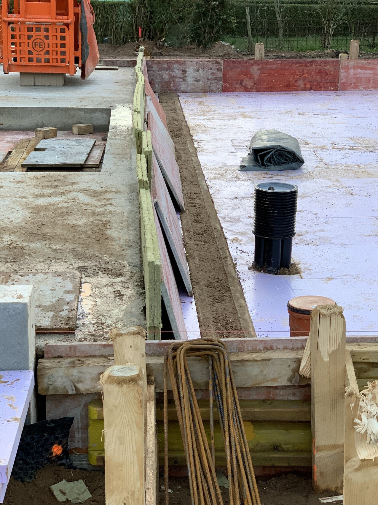

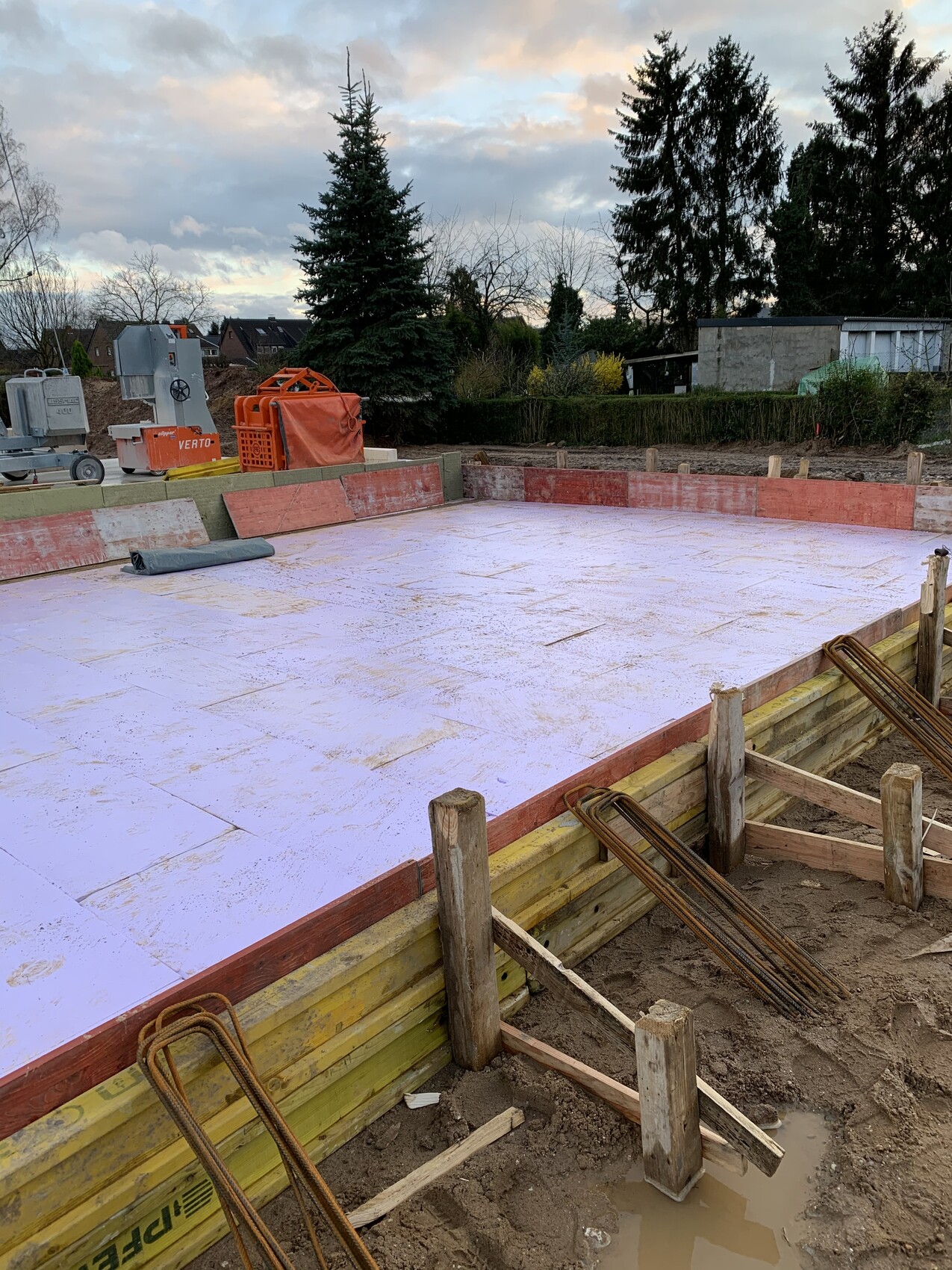

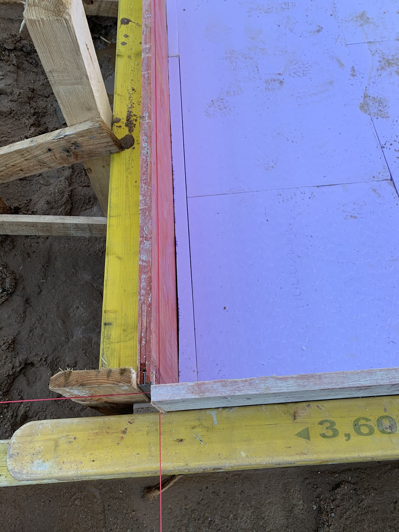

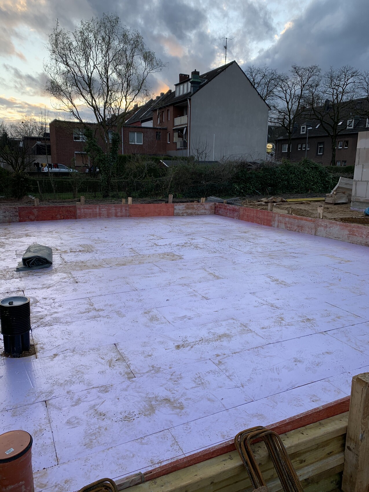

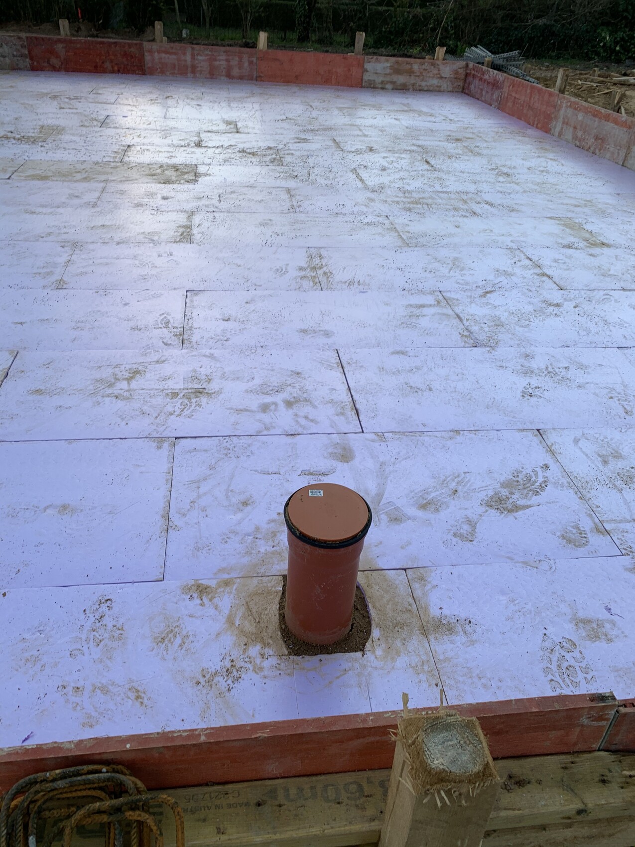

Leergut6411 Mar 2020 20:30Hello everyone,
Our construction project has finally started after some back and forth about the foundation wall, since my neighbor is building with a basement and I am not.
We were able to reach an agreement, and today work began on the slab-on-grade (ground slab).

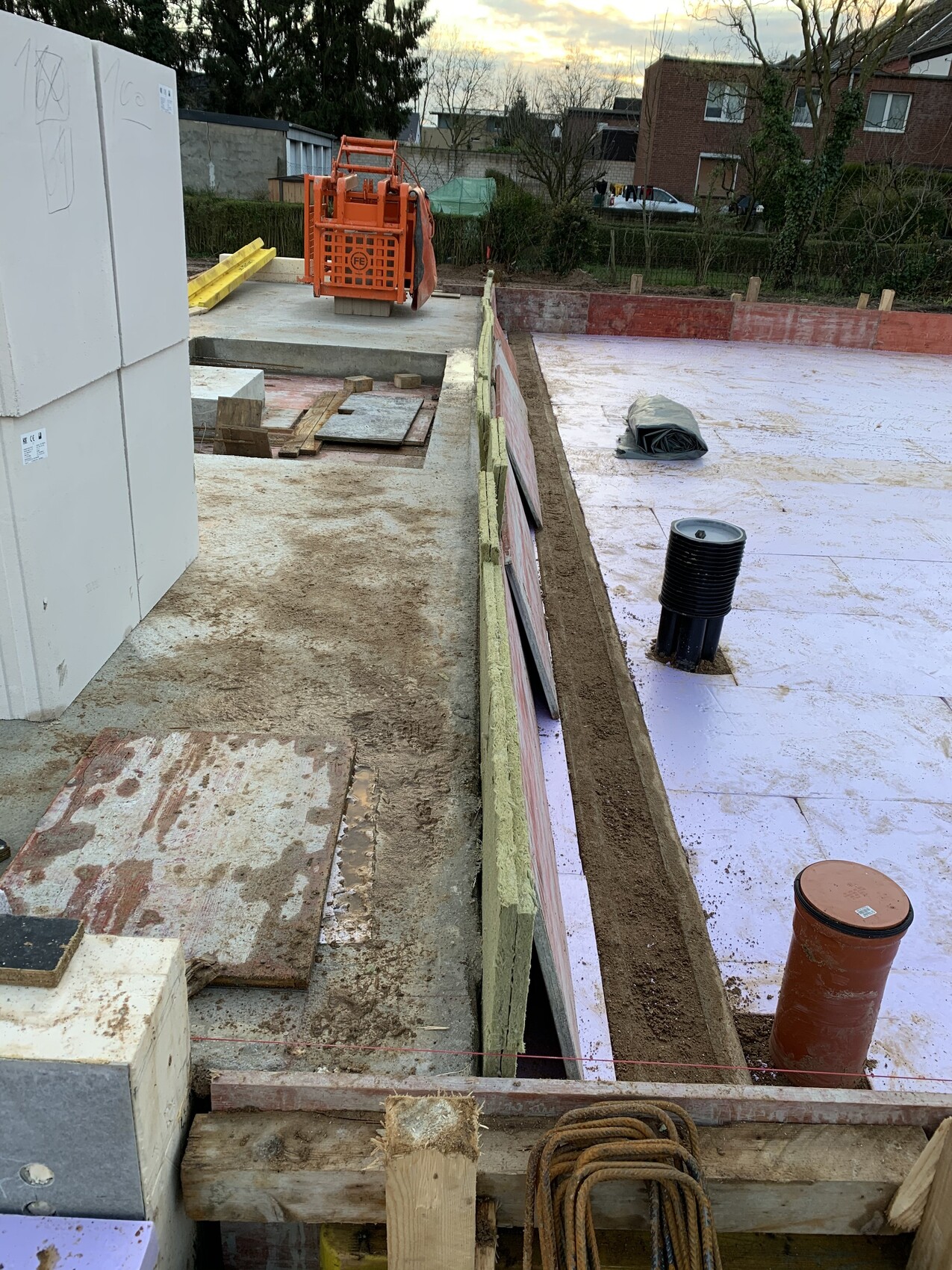

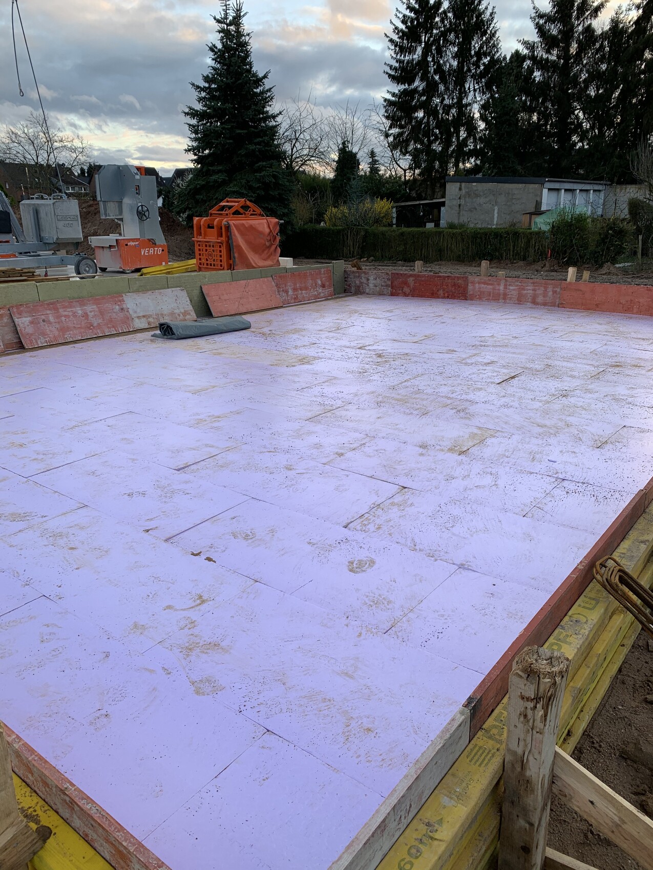

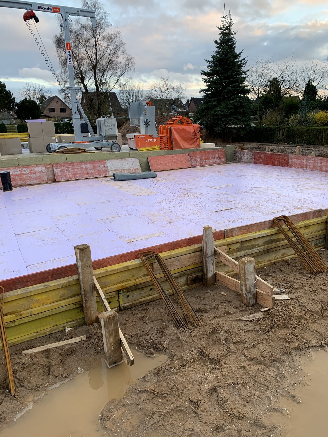

I’ve attached some photos.
- Do you have any general tips on what to watch for with the slab-on-grade?
- Are there essential things that need to be considered?
- No gravel layer, vapor barrier, or anything else was installed under the Jackodur insulation boards—should I accept this?
- When is a vapor barrier necessary?
- What should be considered regarding the steel reinforcement?
- What do I need to watch for during the concrete pour?
- Is there a vapor barrier to be installed afterward?

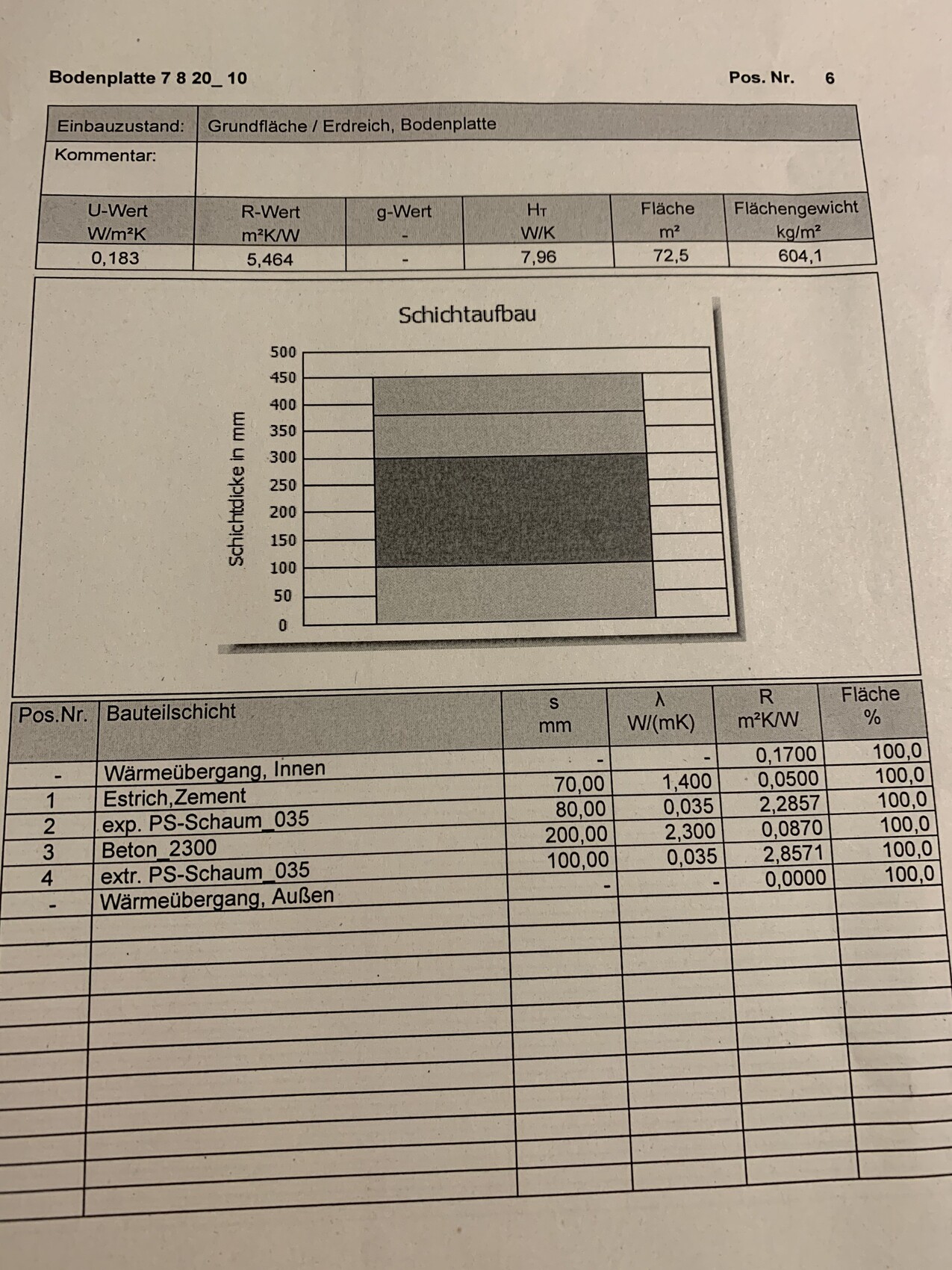

I have also attached the composition of the slab-on-grade according to the energy saving ordinance calculation.
It mentions an expanded polystyrene (EPS) foam type PS_035 under the concrete. However, I have not seen this installed at my neighbor’s place.
- Should I insist on including this?
- No Jackodur insulation boards were installed in the area of the foundation wall.
Can anyone explain why?
Doesn’t this create a thermal bridge?
I am really grateful for any advice, as my construction supervisor is out sick, and I want to prepare as much as possible before he can approve the slab in two weeks.
Please, no negative comments—save those. Constructive criticism is welcome anytime.

How is this supposed to work without gravel under the foundation slab? The water will just wash the soil away.
Or were you simply not on site when it happened?
What do you mean by having an agreement with the neighbor? This is not your problem, and certainly not your expense.
You should pay attention to the foundation or the foundation soil.
Is there a reinforcement plan? Make sure the correct amount of steel is included.
If there is no waterproofing from below, then apply it from above before the screed is poured.
Measure the positions of the drains carefully.
And take photos of everything, also later during the shell construction phase; they are helpful.

And take photos of everything, including later during the shell construction; they will help. Is that possibly the gravel or crushed stone layer? See attached image.
Is a bitumen membrane still needed above the foundation slab as a vapor barrier?
