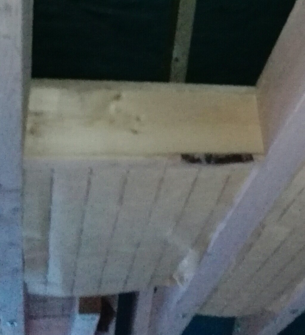

During the construction of our new terraced house, the roof has just been completed. We noticed that the wood where the folding attic ladder will be installed is darkened. Additionally, the surface is no longer smooth. There are clear indentations and dents visible.
Could you please take a look at the photos and provide some information?
This is the dangerously feared common tree edge. 😀
Seriously: this is the area where the tree bark used to be. All good, no need to panic.
