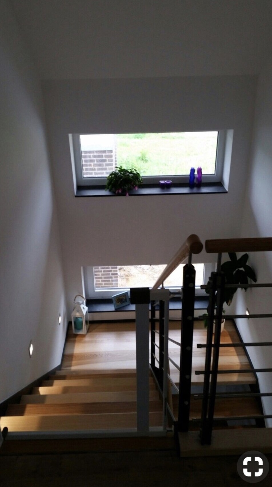

I’d like to revive my thread and ask whether it’s possible to build a staircase like this given the conditions mentioned in the first post. I’m not sure if I might hit my head when going down to the basement or if a width of 1 meter (3.3 feet) is sufficient. At least in the photo, it doesn’t look any wider, and we really like it!
