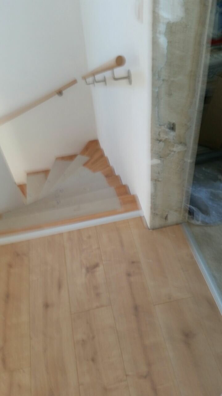

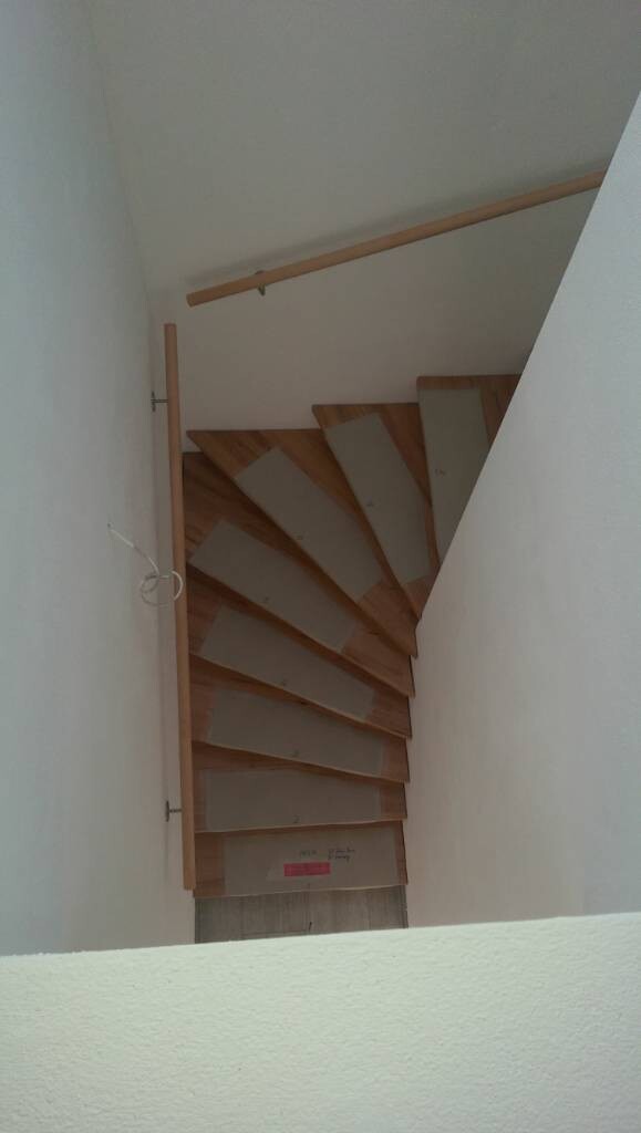

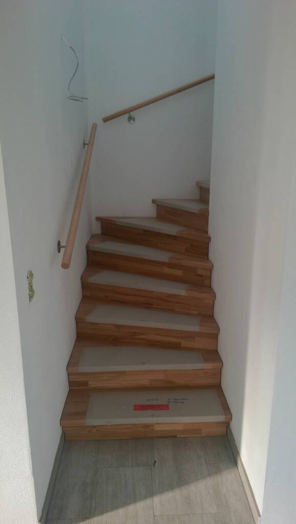

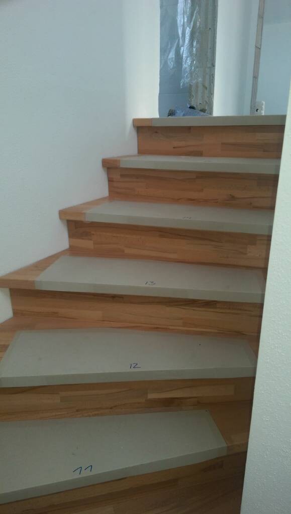

Here is our steel stringer staircase with risers.
2.13 meters (7 feet) wide * 2.36 meters (7 feet 9 inches) deep
Unfortunately, I don’t have any more detailed pictures on my phone.
I can provide more this evening.

So, if I imagine the balustrade width taken away, the staircase is about 2 meters (6 feet 7 inches) wide. At first glance, it doesn’t look uncomfortable.

Zaba12 schrieb:
So, if I imagine the width of the railing removed, the staircase is about 2m (6.6 feet) wide. At first glance, it doesn’t look uncomfortable.
For us, it is completely fine.
The Ikea Pax wardrobe has been placed on top of it, and our 2 1/2-year-old climbs up and down it quite safely.
