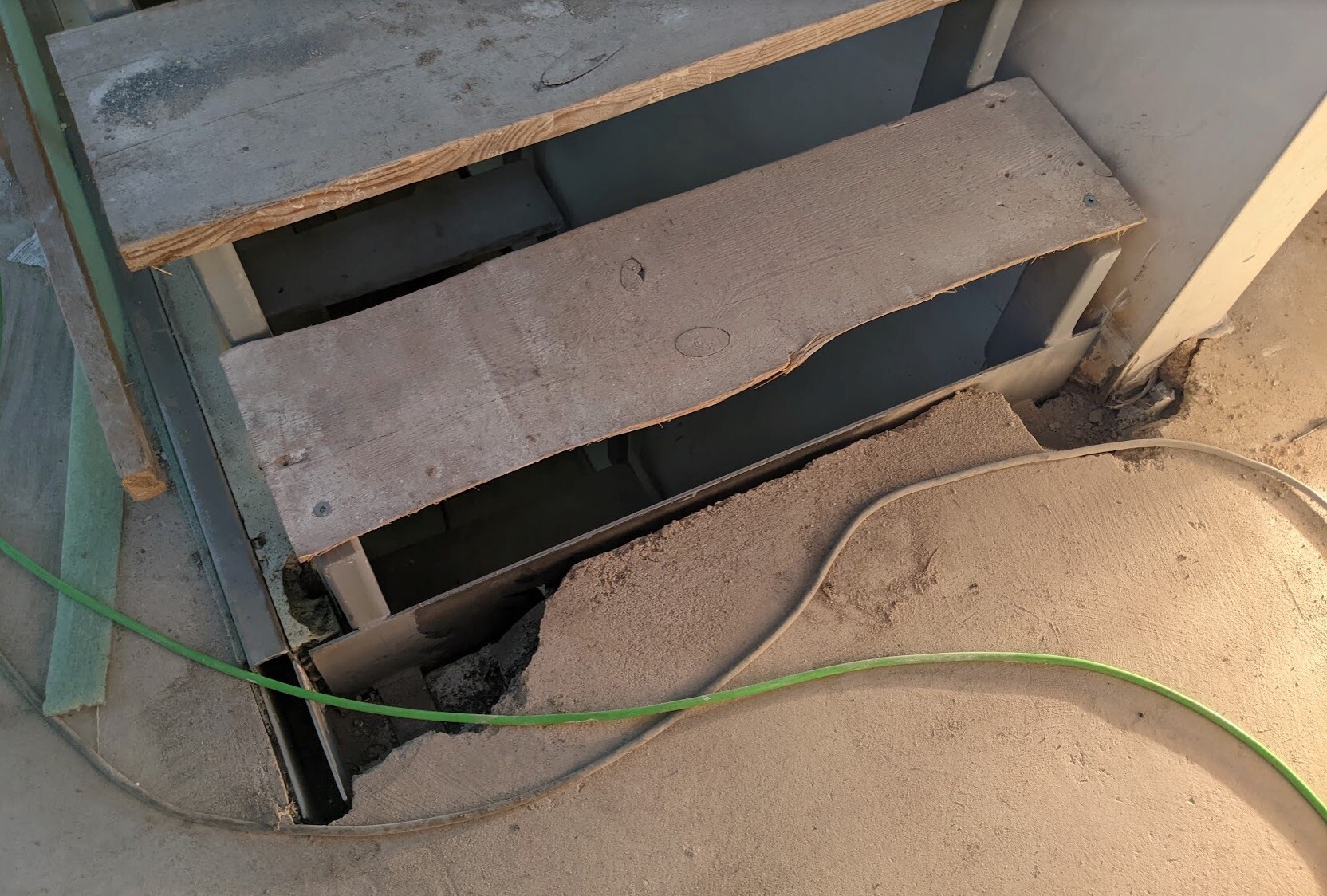

morgenstern13 Jan 2022 19:14The staircase will be dismantled but will remain hanging on the pulley system.
At the top, the staircase will be shortened; at the bottom, it will be fitted with a board and reattached.
The wall fixtures will, of course, need to be redone as well.
Effort required: 2 people for a full day.
Then, the area will need to be plastered and the holes in the screed filled.
The heating pipes of the underfloor heating are not in the way.

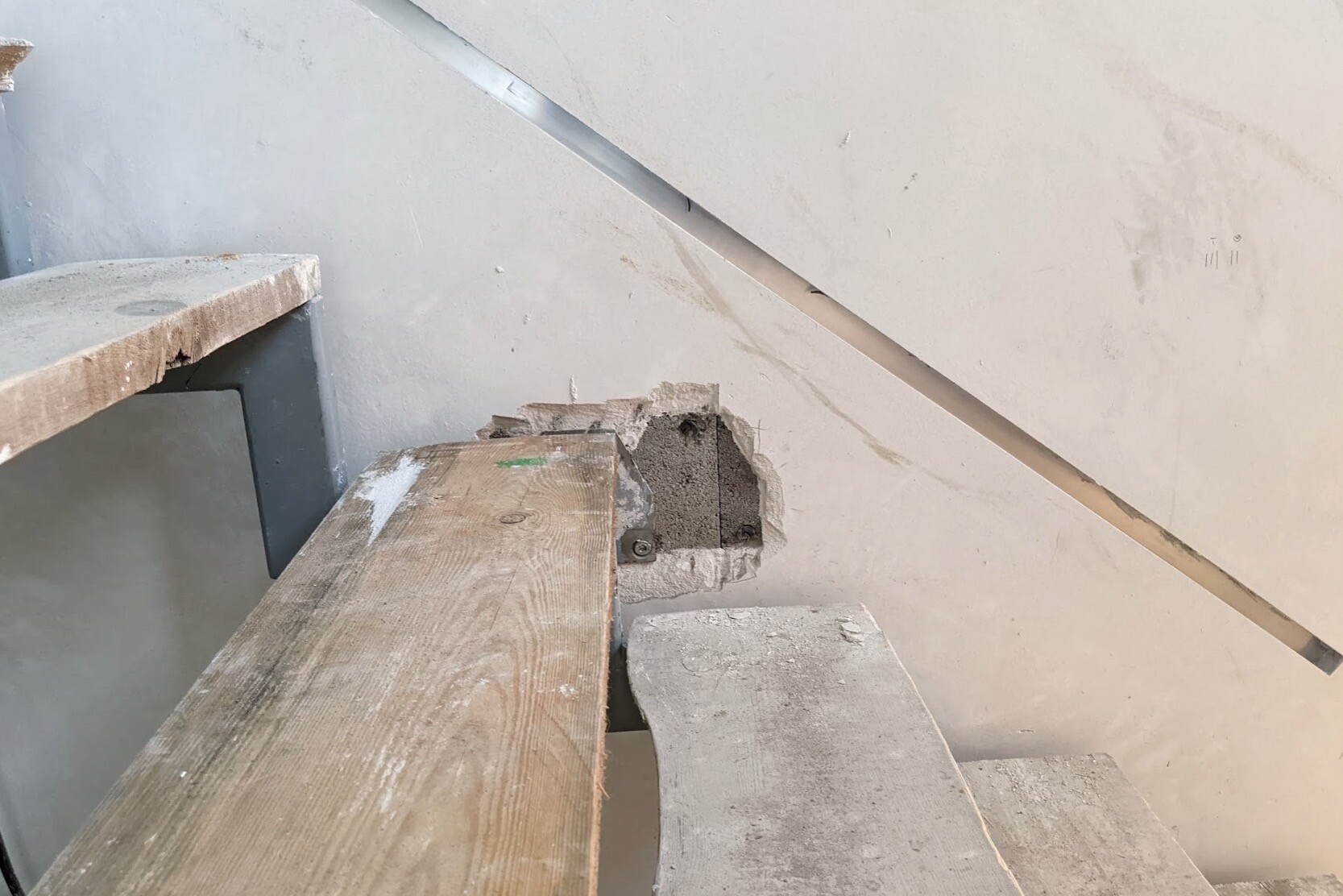

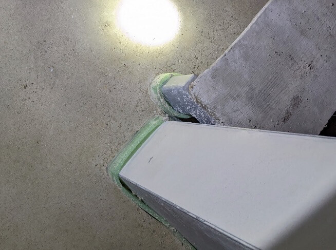

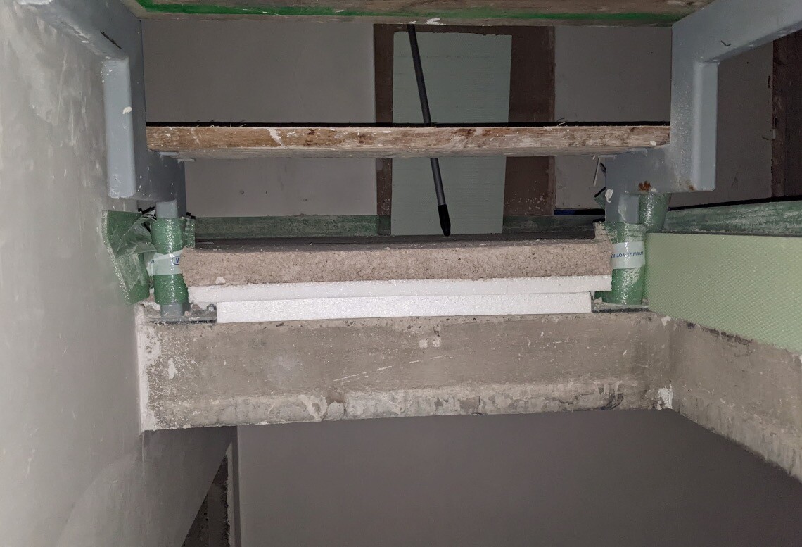

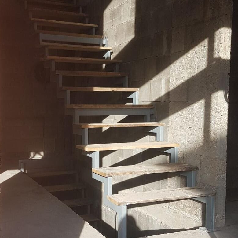

morgenstern2 Feb 2022 15:34So, the staircase has been adjusted:
As a reminder, this is how it looked before:
Thank you very much for your support!
