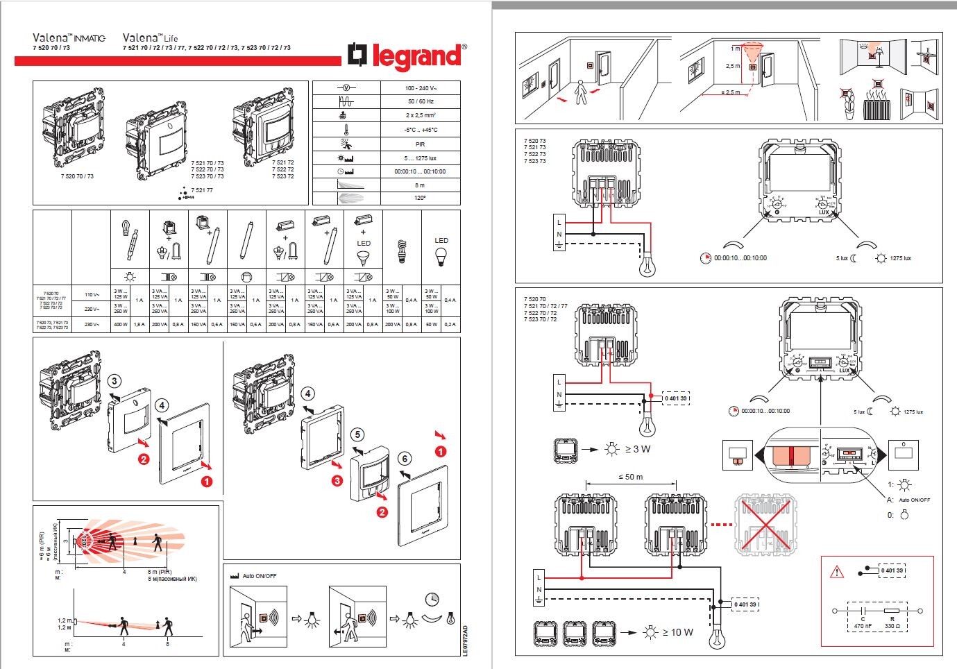

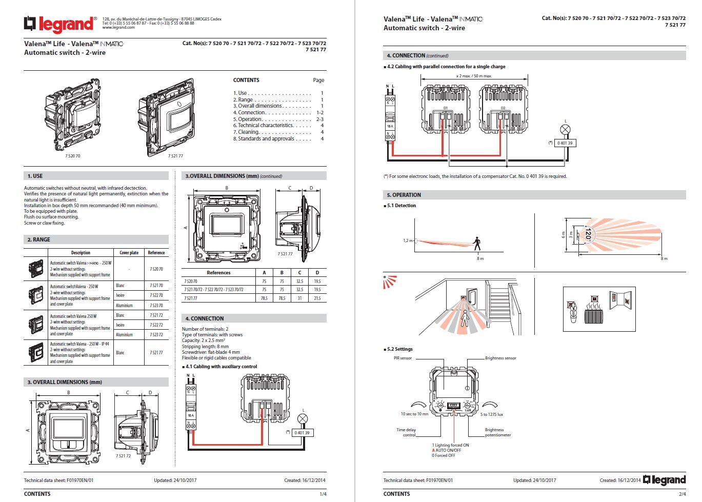

We are using the Legrand Valena Life (752073) 3-wire motion sensors. When I check the description on Elektroland online, it says “Only intended for single operation (no parallel connection of sensors possible).”
Apparently it is possible, but maybe that’s the reason why these devices fail or don’t work properly.
There is also the 752172 model from Legrand, but the description states “max. 2 in parallel.” And this one is only 2-wire.
Now the questions:
1. In my opinion, it’s not possible (or at least not without problems) to operate the mentioned sensors in a 3-way parallel connection.
2. Can you recommend a motion sensor to use instead?
3. 2-wire or 3-wire? We have 3-wire installed with three wires connected, so I assume 3-wire is correct...
Sebastian
The images are the datasheets of the two Legrand sensors mentioned above
Now the questions:
Sebastian
