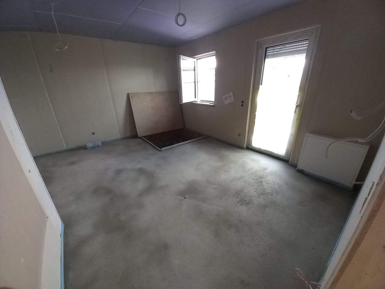

The opening for the staircase between the ground floor and the basement is definitely 1.45*1.45 m (4.75*4.75 ft) in size. Where the window with the light well beneath the terrace in the basement is shown on the plan, we still don’t know if there will actually be a terrace there someday.
My main question is what options we have to install a staircase in a 1.45*1.45 m (4.75*4.75 ft) opening and whether it will meet fire protection requirements. The staircase in question is drawn in the bottom right as a spiral staircase, so it is enclosed by exterior walls on two sides. Attached is a photo of the mentioned opening.
