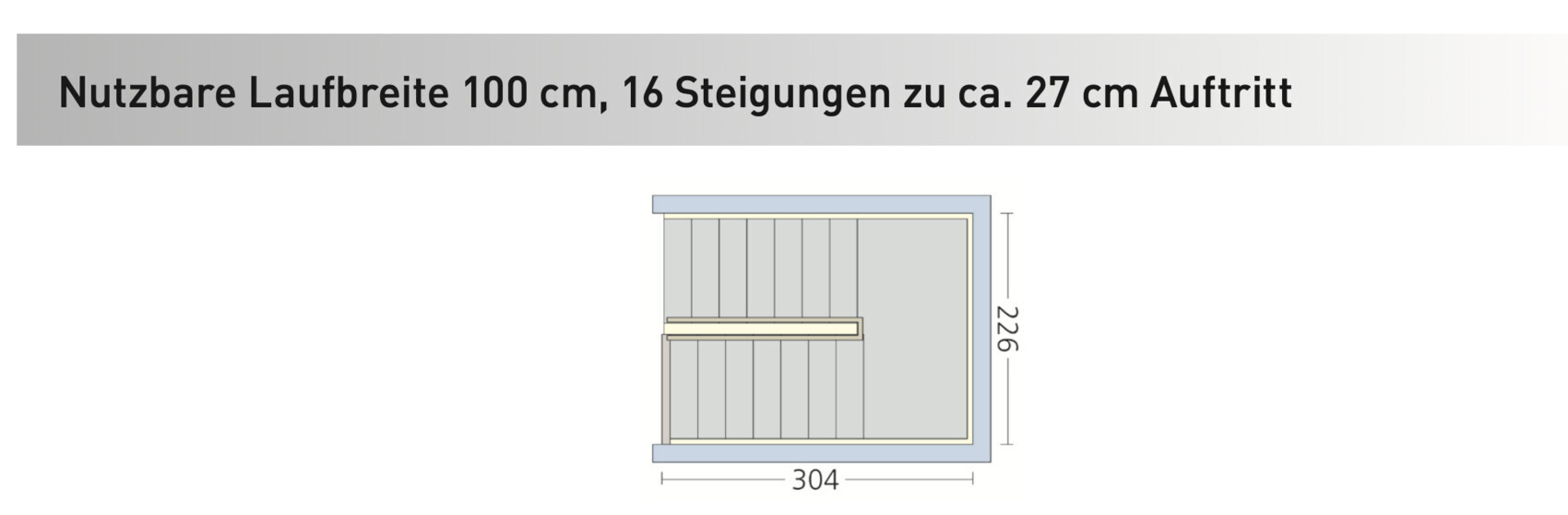

In a few days, we have the staircase selection appointment. On the stair builder’s website, there are layout proposals for the staircase. We have allocated 3.04 meters by 2.25 meters (10 feet by 7 feet) for the staircase area. You can find the house floor plan here in the forum at the following link.
Floor plan #44

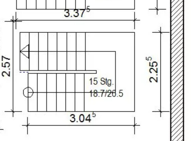

The stair supplier suggests 16 steps for the space online. Here in the forum, 15 steps are mentioned. So I wanted to ask for your opinion again: 15 or 16 steps?
Maybe someone has a similar amount of space for their staircase in their house with either 15 or 16 steps.
Technical drawing of a staircase: 16 steps, approx. 27 cm (11 inches) tread depth, usable width 100 cm (39 inches).
Floor plan of a stairwell in a rectangular room with steps, landing, and dimension lines.
Where?
The picture from Kerstin shows minimum dimensions.
Gregor_K
10 Dec 2023 19:07
Where?
The picture from Kerstin shows the minimum dimensions.
From the post "Floor plan planning – be sure to read before posting".
hanghaus2023
10 Dec 2023 19:13
When I recalculate the planned staircase, I arrive at 16 steps (0.1825 m (7.2 inches) / 0.255 m (10 inches)).
The tread depth is not really generous. Rather too small. You need 3.16 m (10.4 feet) length for the staircase. Or you increase the tread overlap per step by 15 mm (0.6 inches). However, this would not be very comfortable for walking down.
