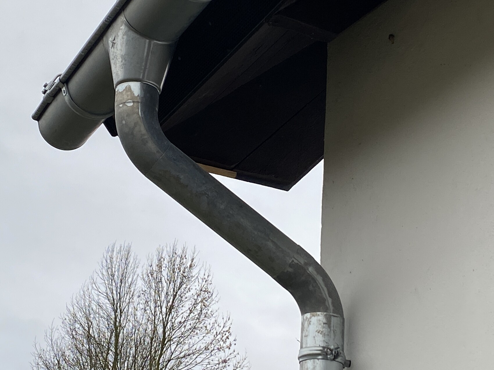

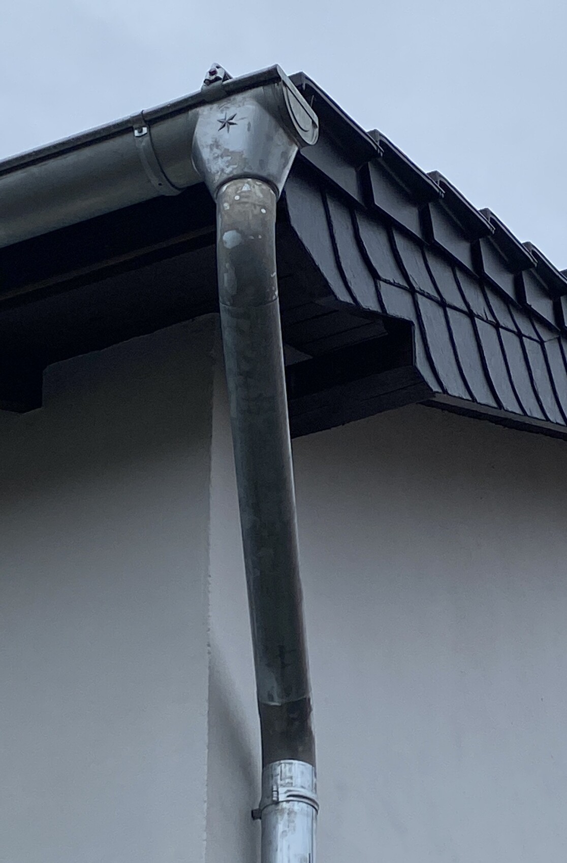

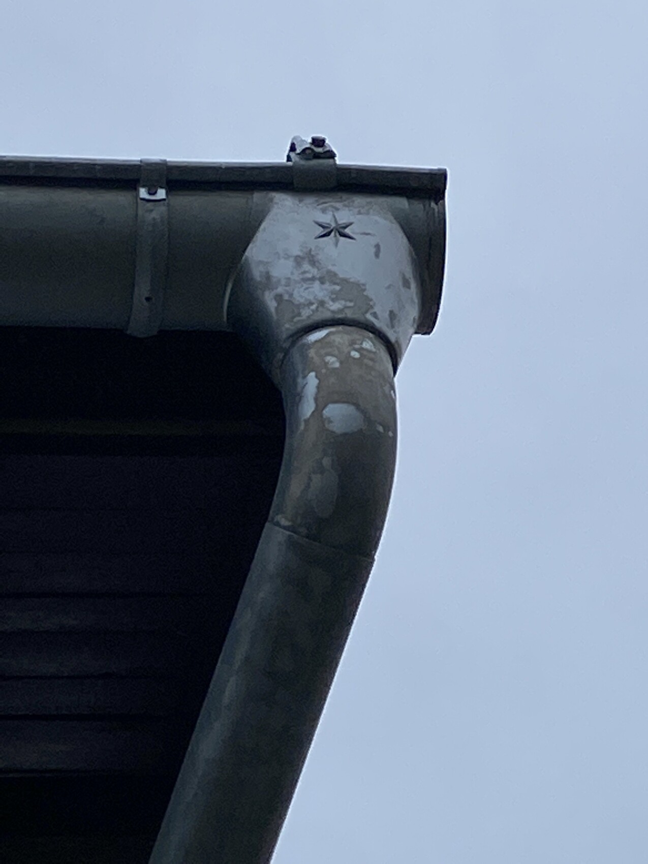

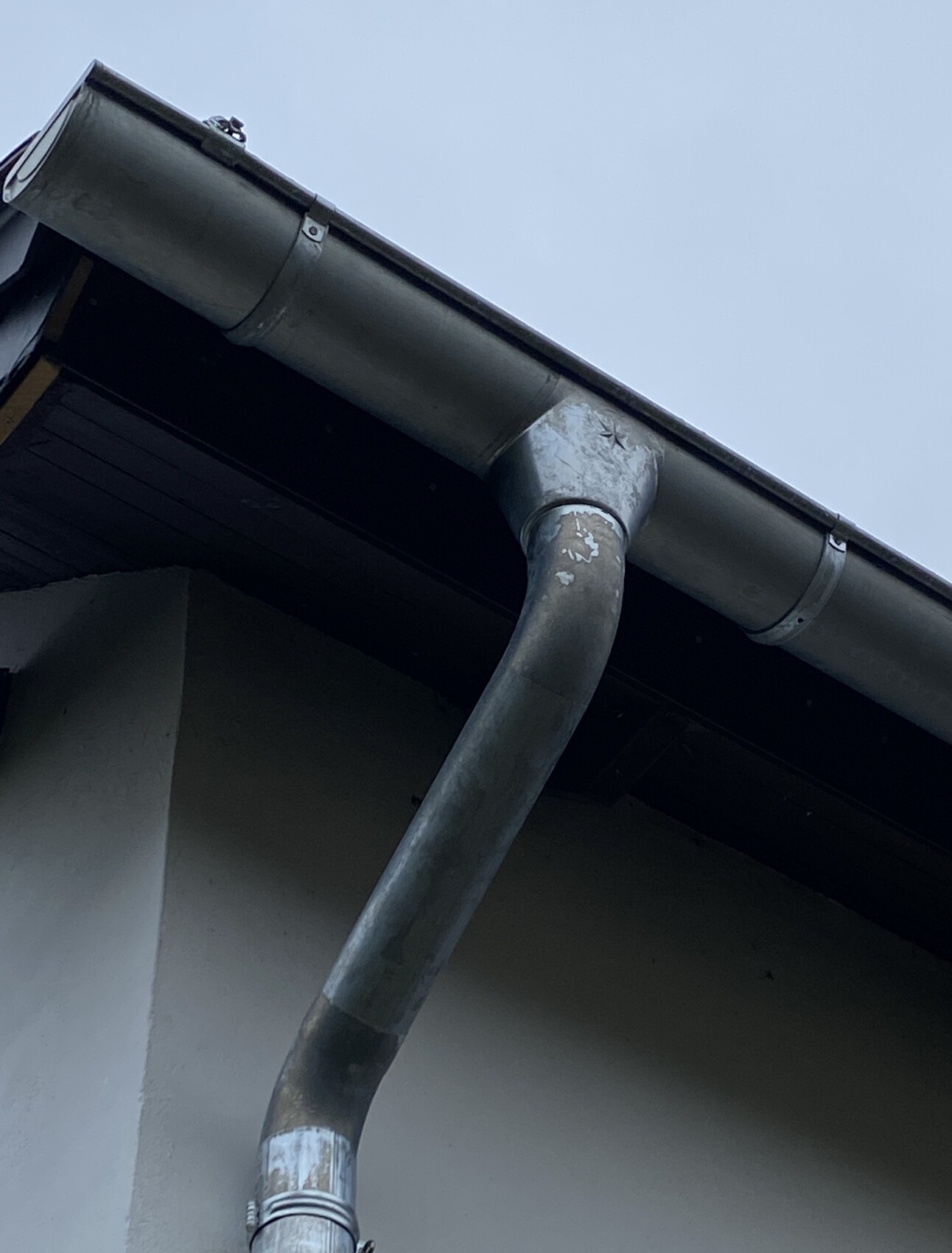

Hello building professionals,
we are fully renovating a single-family house of the EW65 type.
In October 2021, the entire roof was replaced, including reinforcing the roof structure and installing Steico® boards for insulation. All zinc gutters and downspouts were also replaced.
However, only a few weeks after installation, heavy stains appeared on these gutters and downspouts – see attached pictures. The bends and elbows are particularly affected.
I reported this issue immediately to the contractor. The response was not very satisfactory: “It’s true that downspouts develop patina at different rates, which is not very attractive […] but it will eventually even out.”
Winter weather conditions prevented any action at the time, but now in early summer I would like to address this again. I have a newly replaced roof with a roof exit, heating boiler vent, etc., but these really unsightly gutters and downspouts remain – for me, this is unacceptable since I have never seen this with a newly replaced roof.
Now my question(s): Is this a material defect, or what is causing these stains?
Is this issue covered under the roofer’s warranty?
Best regards.
Best regards.
Benutzer 100131 May 2022 05:10This is a natural oxidation of zinc.
Completely normal for zinc. It oxidizes… take a walk through new housing developments and have a look around.
HilfeHilfe31 May 2022 05:38Completely normal... There's nothing you can do, or you could replace it with plastic.
Neubau202231 May 2022 06:37HilfeHilfe schrieb:
Completely normal....... There’s nothing you can do, except replace it with plastic.Or paint it after oxidation.
