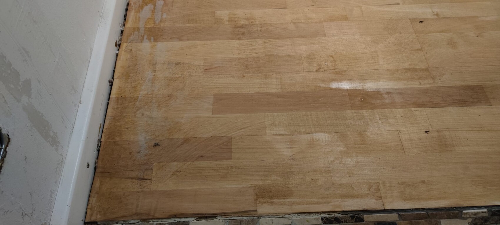

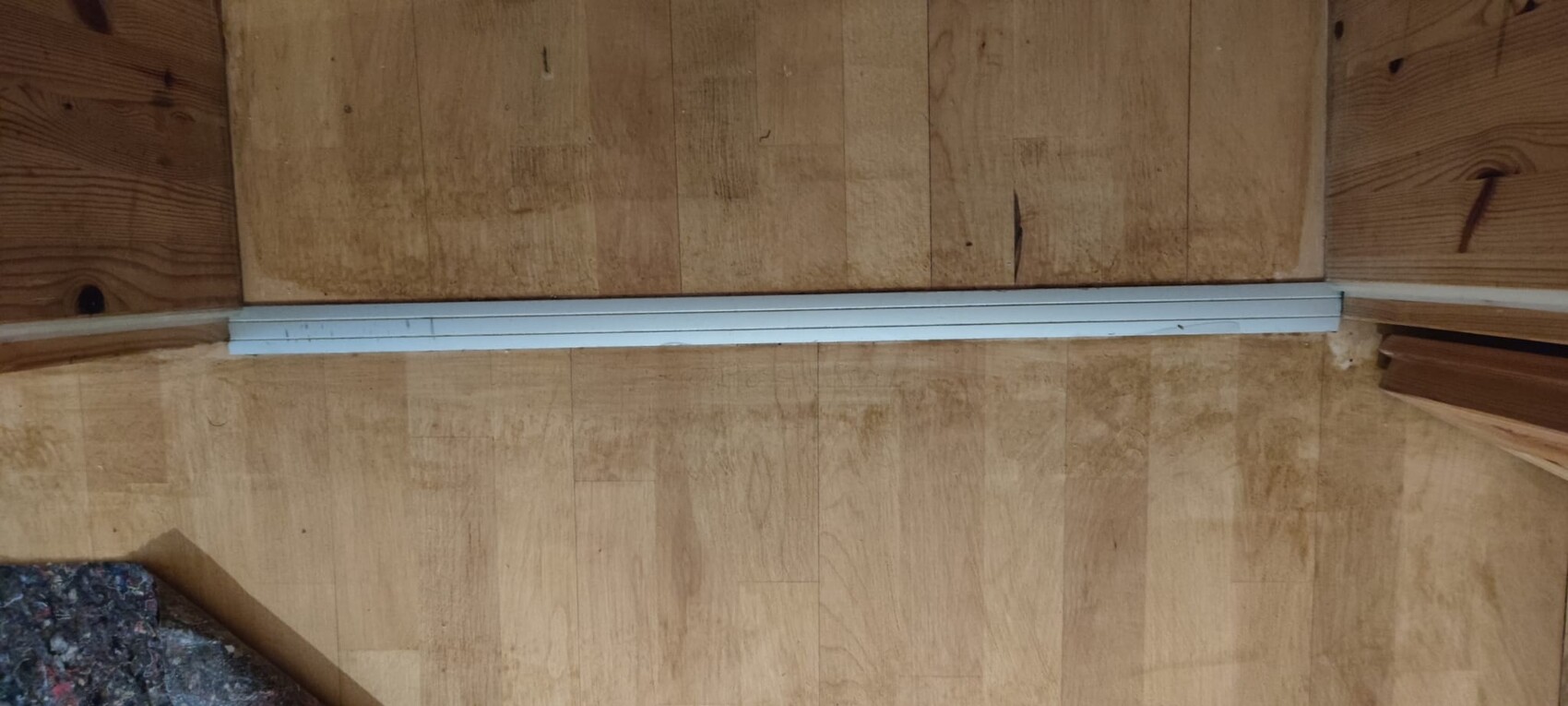

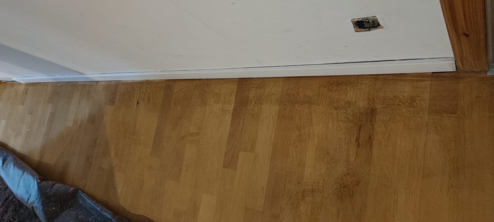

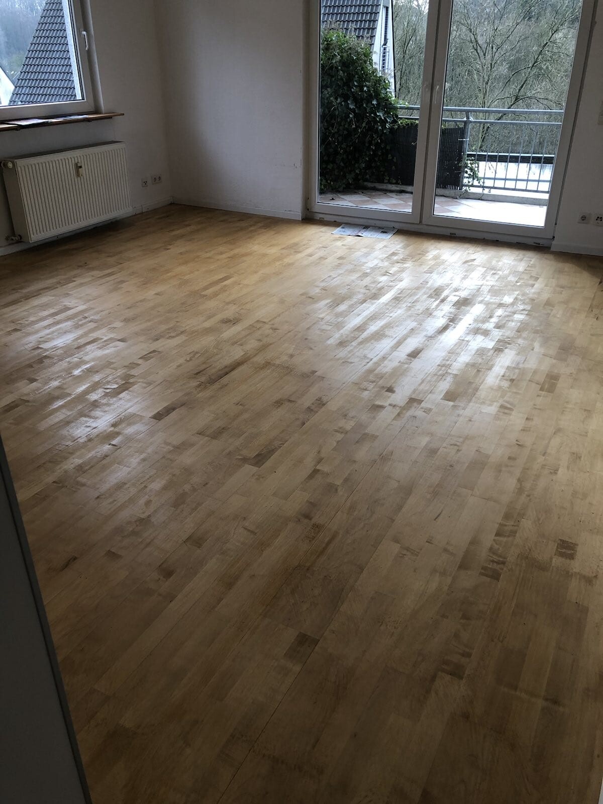

I would like some help with my parquet floor. It was sanded with 100 grit and then oiled. Now it has some blotches.
How can I improve the appearance of the floor? I’m attaching photos.
Thank you in advance

Was the correct oil used?
Was the manufacturer’s instructions for the oil followed?
The surface still looks a bit damp in the last photo. Perhaps the oil needs to soak in further and then be polished?

There was paint on it before, absorbed to varying depths,
and sanding didn’t remove it all.

In my opinion, 100 grit is quite coarse for that. It also depends on whether you sanded the room with a machine and then did the edges where the machine couldn’t reach by hand or with another (smaller) machine. That’s what it looks like to me. Additionally, it seems like you wiped in different directions.
I think you’ll need to go over it again. Did you have color pigments in the oil?
In the overall shot, it looks like the floor only absorbed the product partially, creating a blotchy appearance.

You can clearly see on the door track that the wiping was done in a different direction there. At first, I thought it was along the track, but apparently, it was removed beforehand? Or not?
where @pagoni2020 mentioned it: it could be that it wasn’t stirred properly or a dirty brush was used. You can clearly see where the wipe marks start.

Is this sticking? I’m guessing it might be too much oil. It looked like that in some spots for me as well.
