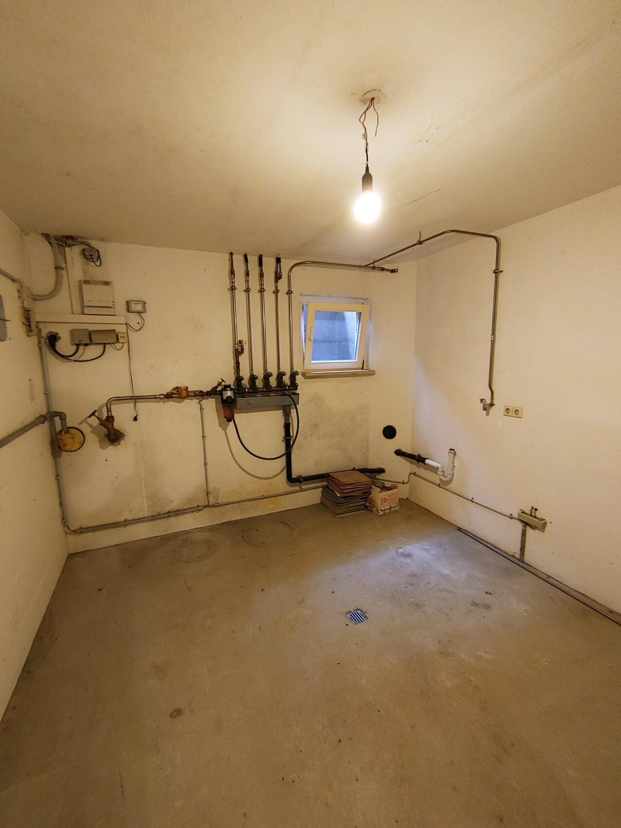

HubiTrubi4015 Sep 2021 02:47Hello everyone. I am currently in the process of buying a house, which I described in another thread. However, while looking through the photos, I noticed some stains or discolorations in the basement (see photo). That’s why I’m asking here in this specialized forum. I couldn’t detect any odor or mustiness. What do you think? Could this possibly indicate moisture? Thanks in advance!
HubiTrubi40 schrieb:
Could this possibly indicate moisture? Try to find out the previous use of the space.
If laundry was regularly hung there to dry, the issue should be resolved after a few days of using a dryer.
Just place a hygrometer and use a capacitive moisture meter for the wall;
then the answer will become clear.

I completely agree with you. However, I thought this was a more specific question and would be better suited for the "masonry" forum. This concerns the middle unit of the row house from the thread above.Row house, window side… if only we also had the year of construction and preferably a photo of the garden in front… 🙄. But it’s your thread, so it’s up to you. My guess is: for a relatively new house, it looks quite worn out 😉
P.S. I also recommend using a moisture meter.
