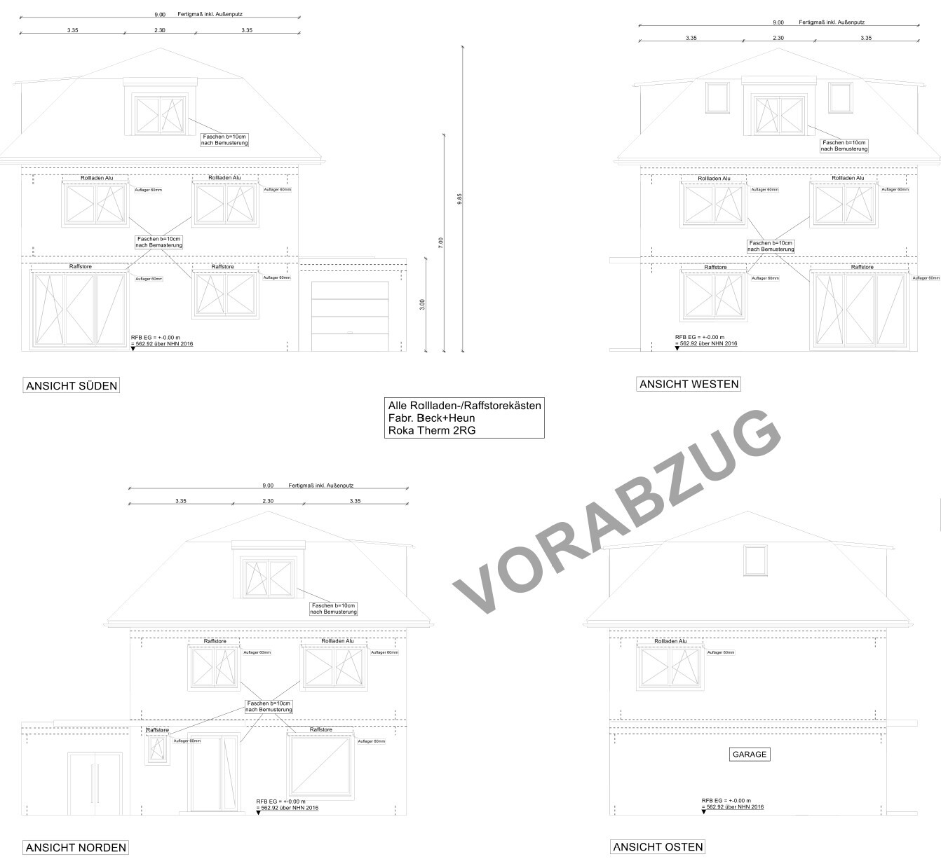

Hello house building forum,
First of all, a word of apology is in order. Some of you may remember my previous thread with an almost finished design. Unfortunately, it was never realized for various reasons that I won’t go into here. I apologize for not updating that thread anymore, but I also don’t want to bump it now with a new post. I have learned a lot from your comments. The good news: your support was not in vain, and much of your feedback has been incorporated into a new design!

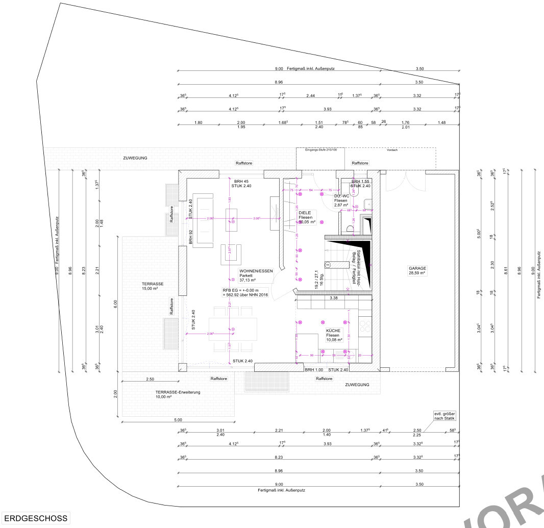

We are now planning a square-shaped single-family house on a somewhat smaller plot. The detailed construction plans will be completed in the next few weeks, so there is certainty that this design will be implemented. I want to make up for it with new pictures/designs and am, of course, looking forward to constructive feedback again!

Good evening, I just want to quickly address something regarding your dining table. Does the specified size fit the room dimensions?
Best regards, Jasmin Thank you – the table is of course 1m x 2m (3.3ft x 6.6ft) and extendable to 1m x 3m (3.3ft x 9.8ft)... But I don’t think I can edit the post anymore.

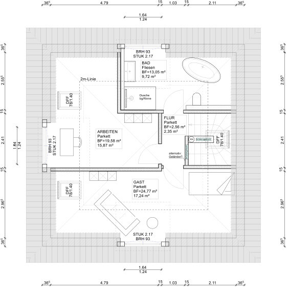

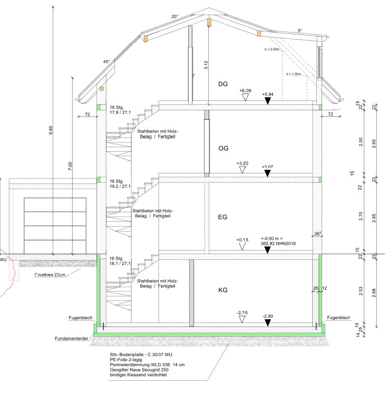

When it comes to floor plans, everyone here is much better than I am... But I would have some doubts about the bathtub in the attic being completely behind the 2m (6 ft 7 in) line. If I’m seeing it correctly, it’s located outside the dormer, right? That will get really tight. Is there an option to place it directly on the roof rafters to save on floor buildup height in favor of headroom? Or is it intended to be freestanding? We are currently building directly along the 2m (6 ft 7 in) line, positioned 10cm (4 inches) within the screed/insulation level, and still have 16cm (6 inches) more headroom due to the open roof structure (the 2m (6 ft 7 in) refers to the start of the joists and the top edge of the finished floor). I definitely wouldn’t want any less headroom in a single-family home—especially considering the challenges with waterproofing against splashing water and the very limited head clearance. Is the pitch there 45 degrees?
It’s going to be a tight fit… I need to take a closer look. It will work again, though with some compromises. In my opinion, the toilet on the upper floor or rather the entire bathroom is the main issue. I have an initial suggestion: move the garage all the way towards the top of the plan.
hanghaus20234 May 2024 11:05Could you please mark the north arrow? Where is the street corner located?
