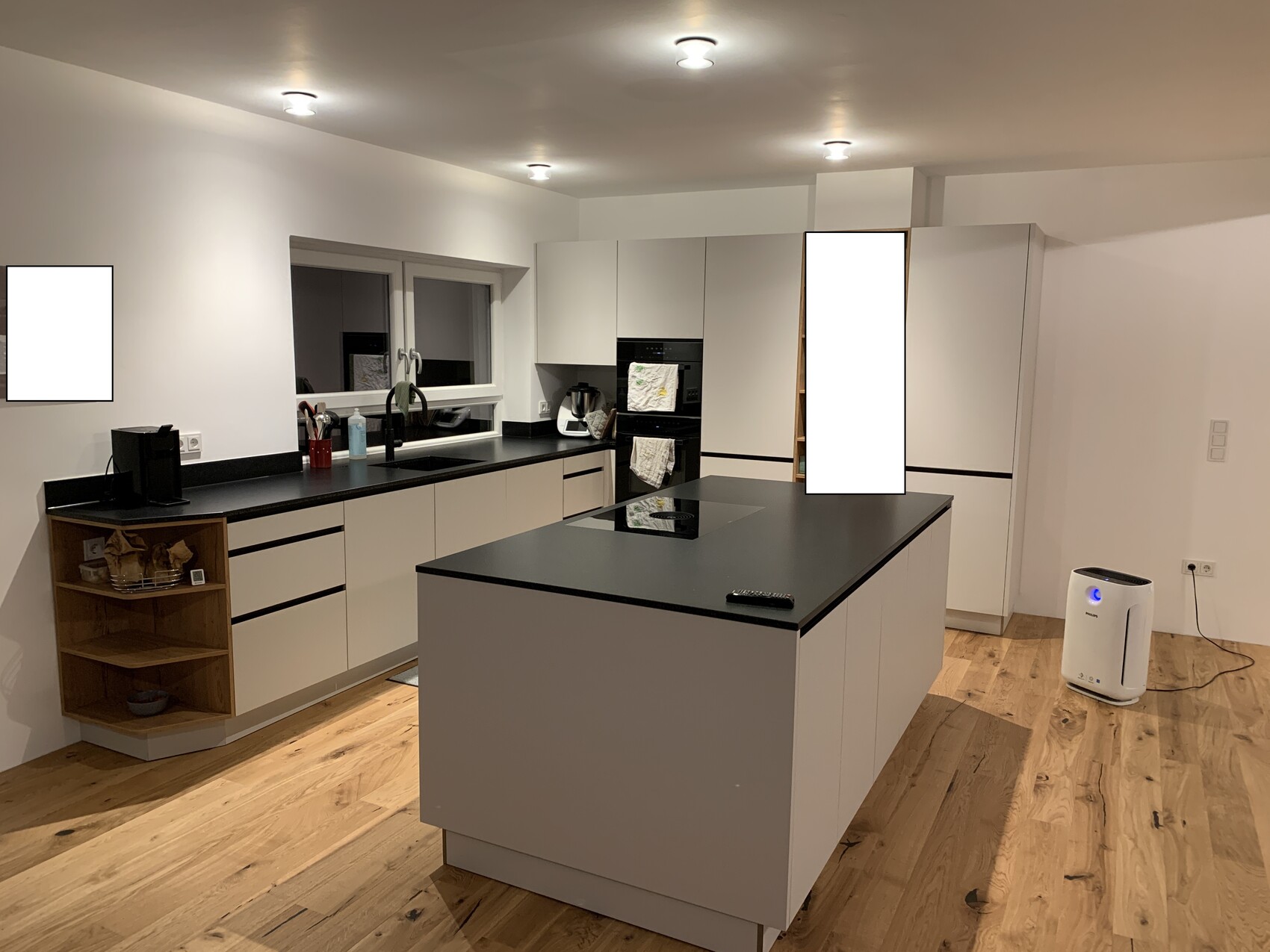

Allthewayup30 Jan 2024 18:45ypg schrieb:
Thank you. I thought you might have already finished and moved in by now?! Or is that an “old” photo? I’ll wait and see. We were also ready to move in twice already.
It got postponed again by 4 weeks—various reasons…
But the photo is not from today either; it was taken around New Year.
For example, we have 4 ceiling lights, no spotlights despite the suspended ceiling. According to our lighting consultant, spotlights are still possible but are somewhat out of fashion, or at least don’t look as appealing when used alongside many other lights. However, I think this is partly a matter of personal taste.
In addition, you should naturally choose the lamps depending on the number of outlets. We have 4x:
"Ribag ceiling light VIOR incl. converter, 350mA, 12W 750lm 2700K 60°, phase-cut dimmable, white, IP54. It looks especially nice in the dark because the Plexiglas is not visible, making it appear like an open fixture.
Good luck
