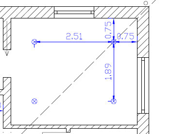

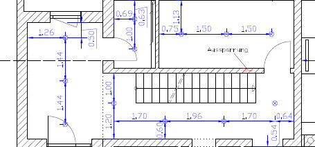

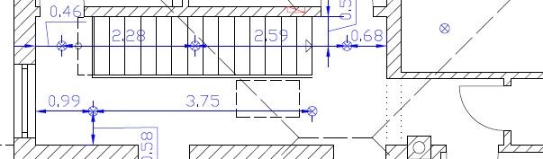

I’m currently thinking about our plan for the recessed spotlights and am having trouble making progress.

Upper floor hallway: The area behind the beam still needs to be integrated sensibly. Is there even enough light?
Basement hallway: Is the arrangement okay like this? Is the lighting sufficient?
Bedroom spotlights: The bed will be placed against the wall at the bottom of the picture with two pendant lamps hanging from the ceiling as bedside lamps. Do I even need 4 spotlights, or would maybe 3 in a row on the opposite wall be enough?
At the moment, I can’t find any solutions without covering all the rooms with spotlights...
Maybe someone has better ideas.
