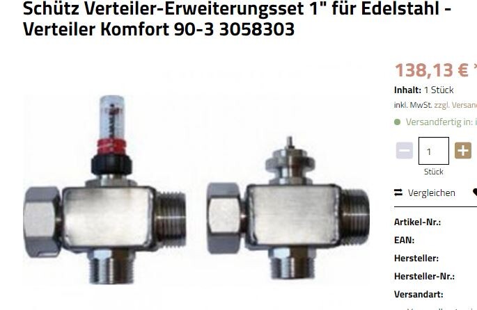

But then I'd rather just stick with the bathtub. Depending on the manufacturer, there are also manifold extension kits available to add 1-2 heating circuits, but the distribution cabinet must have enough space to accommodate them...
I checked and it’s PE crap 😉
