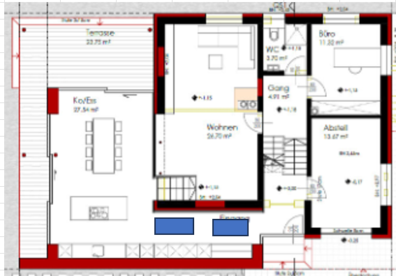

Additional requirements: The house needs a complete renovation. It is a single-family home with split levels. We wanted direct access to the garden at ground level, so our architect recommended an extension for a cloakroom, hallway, kitchen, and dining room. This extension is planned as a wooden construction (vertical spruce cladding painted black). The living room (accessed from the dining room by 7 steps), toilet, and office are located on the first split level, then one half level up is currently planned as the master bedroom. This floor contains only this one room. One more half level up / on the top floor, there are two equally sized children’s rooms plus a toilet and bathroom planned.

- Open space combining kitchen/dining and living room with 7 steps – maybe the entrance could be raised to reduce this to 5 steps to the living room. Do we need fall protection, and if so, what kind?
- Spacious areas, especially in the living space
- Children’s rooms orientation and size
- Generally generous spaces in the basement, WC, and office
What do you not like? Why?
- Unsure whether the open kitchen/dining/living layout is community-friendly enough and if steps will be inconvenient in daily life
- Unsure about the size of the kitchen/dining area and the window/glass front in the dining/kitchen area
- Terrace planning: dining area on the west side planned by the architect, but rather narrow. Unsure about the 2 m (6.5 ft) terrace on the south side — what would really fit here? Will everything be covered?
- Still unsure how the extension will look visually (original house facade white, wooden-aluminum windows in black, extension in modern timber construction with vertical spruce cladding in black)
- Unsure about the hallway between cloakroom and kitchen – no door (according to architect there should be no door for visual reasons, as the view and movement direction should be toward the dining room, not the upper floor)
- Bathroom and toilet planning in upper floor – maybe combine toilet into bathroom and convert the room (which has no window) into a wardrobe – master bedroom on split level does not allow a very large wardrobe

You can’t smell mess; you can only see it. But it can be tackled with furniture.
I have never really noticed shoe odor (now with three kids...), so I agree with the architect to leave it open.

By now, you should precisely plan your individual layout according to your needs. This includes the exact dimensions of the sink, the type of shower, and the wardrobe elements you require, so that everything can truly fit inside.
Especially because this is a special floor plan, it needs more careful attention in my opinion, including for sockets, lighting, and much more. People’s habits vary so much that I wouldn’t rely on general recommendations alone.
For example, our open-plan living area extends all the way to the roof, and the house entrance/wardrobe area is practically part of this open space. That’s why we also thought carefully about the appearance of the front door, since it is directly visible; luckily, there is no smell.
We also like large glass fronts, although I’m not very fond of lift-and-slide elements—I prefer more fixed glazing. In the kitchen, for example, I could imagine a “normal” door that can be opened up to 2m (6.5 feet) wide when needed. We often just step outside briefly, and in those cases, a regular door is much easier to operate.

Exactly.
I would run tall cabinets continuously from the wardrobe through the storage area into the kitchen. Visually similar, possibly with a ceiling-high shelving divider between the wardrobe and storage, for example, to hold gloves, scarves, bags. This utility room on the right side would then be suitable for wet shoes.

I agree. In many split-level houses, the steps often serve multiple purposes at different times: as seating, play areas for children (who may be in the way but perfectly in the middle of things). Very fitting for the design and a feature that makes a minor daily inconvenience worthwhile.

I’m not really a fan of an open coat area; I can already see how "clutter" or shoe odors could spread all the way to the kitchen.
Don’t build what you don’t like. Take your time to weigh the pros and cons and make your own decision. A door doesn’t invalidate the design.
dbertig schrieb:
The architect said he wouldn’t put a door here because the path should lead from the front door toward the kitchen. Having a door between the coat area and kitchen would make visitors feel like the "path" goes upstairs... what do you think?
I think exactly like the architect. I really like the solution as drawn. The sightlines are great—the lack of a door is, in my opinion, an aesthetic feature. Still: don’t build what you don’t like.

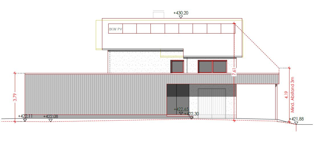

Some time ago, I introduced our project, and now we have made significant progress in the planning—thanks also for your input! We have one more topic to discuss, specifically the east side of the extension. There is no window there at all because the street right next to it is very busy. The extension will have a black wooden facade, but my feeling is that the exterior looks somewhat too plain:

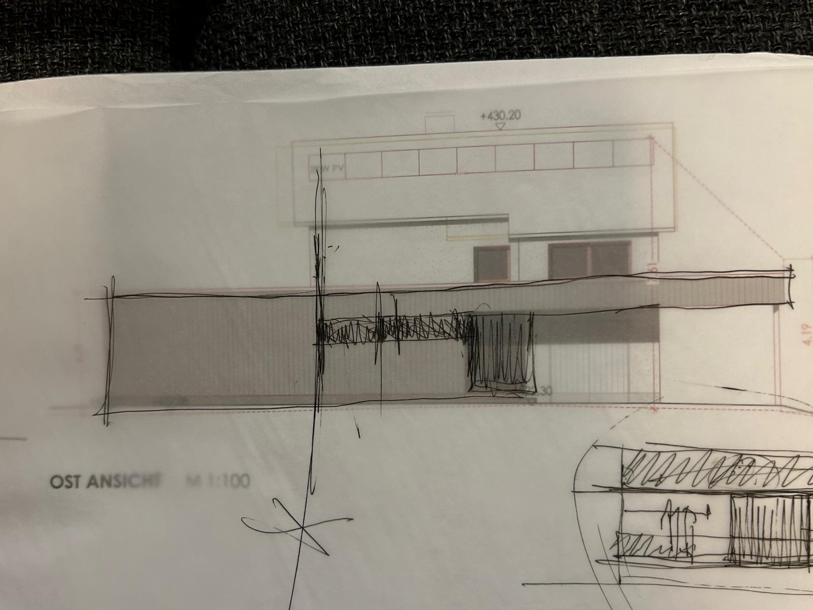

Our architect suggested installing a long, narrow window on that wall. It looks cool from the outside and brings light inside; however, it would no longer be possible to run the cabinets continuously from the hallway closet to the kitchen:
Which option do you think is better? And would it bother you to have such a large extension with no window on that side? On the south and west sides, there will be a glass front.
hanghaus2023
20 Mar 2026 15:55
The version without windows is my favorite. Then rather 2 skylights. Or rather 3 small ones.
