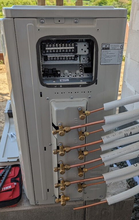

May I ask which manufacturer it is? We would have 2-3 indoor units if at all. In our original house, we also had 2-3 indoor units. That was with Mitsubishi Heavy. At that time, upgrading to one outdoor unit supporting multiple indoor units cost several thousand. This time, we relied on the heating contractor and chose the Remko brand. The exact model is MVT 1403 DC.
We will have a total of 5 indoor units, but only 2 outdoor units. The price difference for us is minimal whether we choose two smaller units or one large one, as we can save many meters of refrigerant piping. The units will be installed on the east and west sides respectively.

KoalasAreCute schrieb:
Using Remko as the brand. Exactly the MVT 1403 DC model.Thanks for that!
