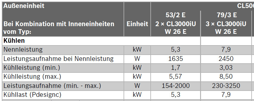

The 7.9kW outdoor unit has a minimum cooling capacity of 3.03kW
This means that if only one of the 2.0kW indoor units runs at full power, the outdoor unit already starts short cycling (which causes higher electricity consumption and wear).

The multisplit combination here has a minimum cooling capacity of only 1.7kW
