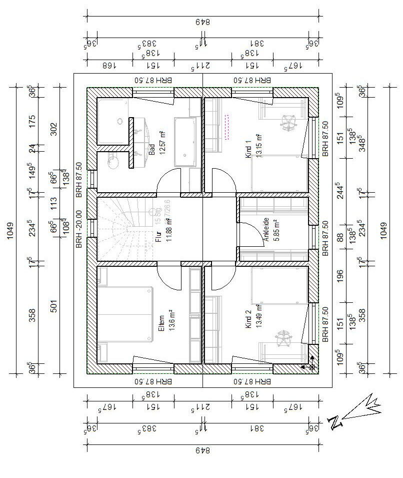

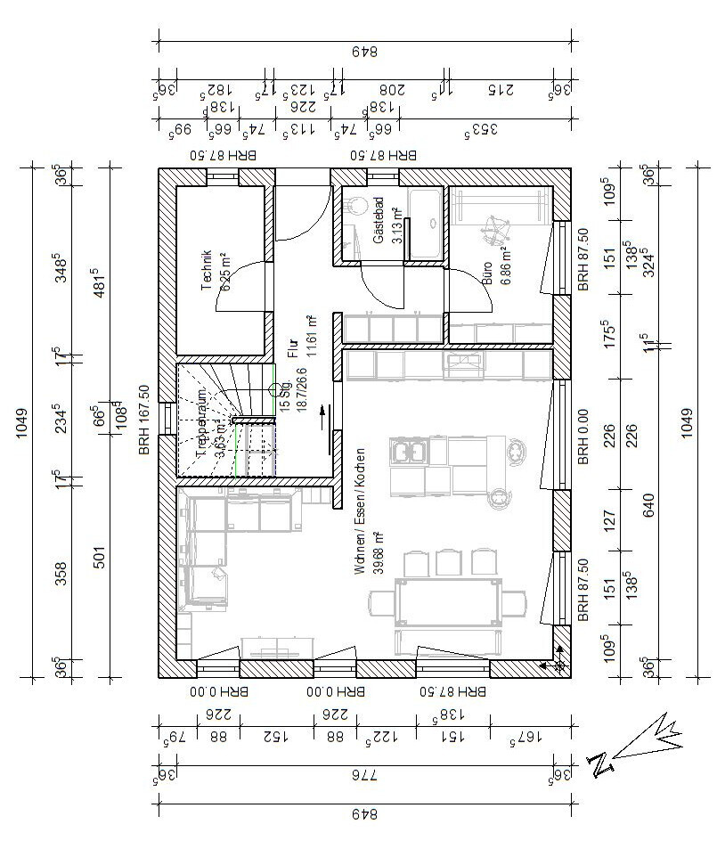

rick2018 schrieb:
No, next to the walk-in closet. It’s all ventilated too. You can hang clothes there, and the dryer is also in that room. Show me how that would work on 160 square meters (1,722 square feet) ... I think we even have 180 square meters (1,938 square feet), but with two children's bedrooms, there really wasn’t any space left for a utility room on the upper floor.
Option 1: This only works with a straight staircase and a square-shaped house, and I also don’t want the washing machine right next to the children’s room because I do laundry in the evening when the child is asleep.
Option 2: And where would the walk-in closet go then?
It’s probably a matter of priorities and workflow. For example, I never hang laundry outside, so my workflow is different. In my case, the utility room, bathroom 1, and walk-in closet are also stacked vertically; if that isn’t possible, it doesn’t make much sense.

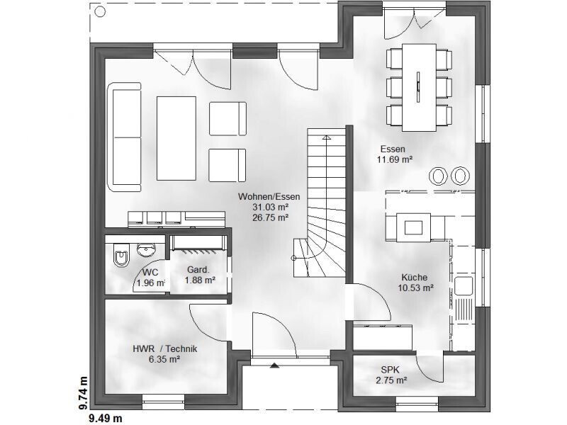

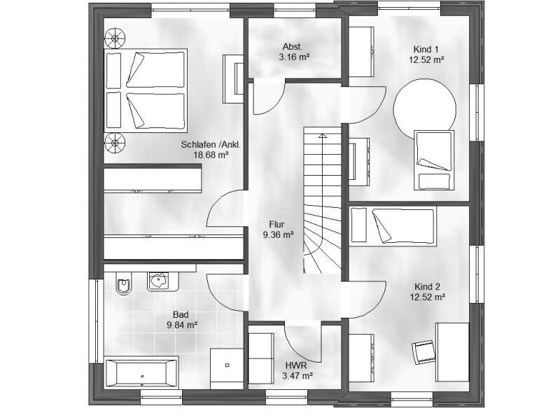

The point wasn’t to provide highly detailed examples that perfectly match your style, but rather to show that you don’t need 180 sqm (1,937 sq ft) of living space to create a functional utility room on the upper floor. Especially if you don’t hang laundry outside anyway, it makes even more sense to do the laundry on the same level where the dirty laundry is generated and where the clean laundry will be stored.
By the way, Example 2 allows for a 350 cm (11.5 ft) wardrobe in the master bedroom, and the "dressing room/utility room" also offers enough space for common laundry items such as bed linens, towels, and so on.
