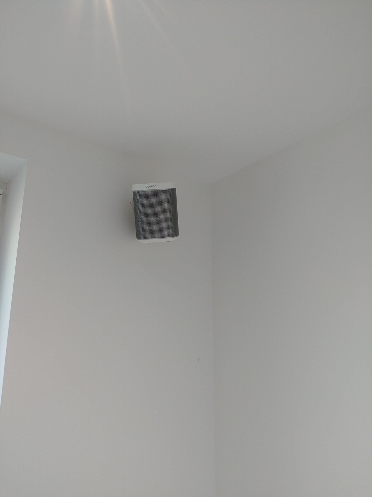

matte
23 Mar 2019 12:31
We have a Sonos speaker in the bathroom. Wired via LAN, controlled through KNX.
White room corner with a Sonos speaker mounted on the wall covered in grey fabric.
