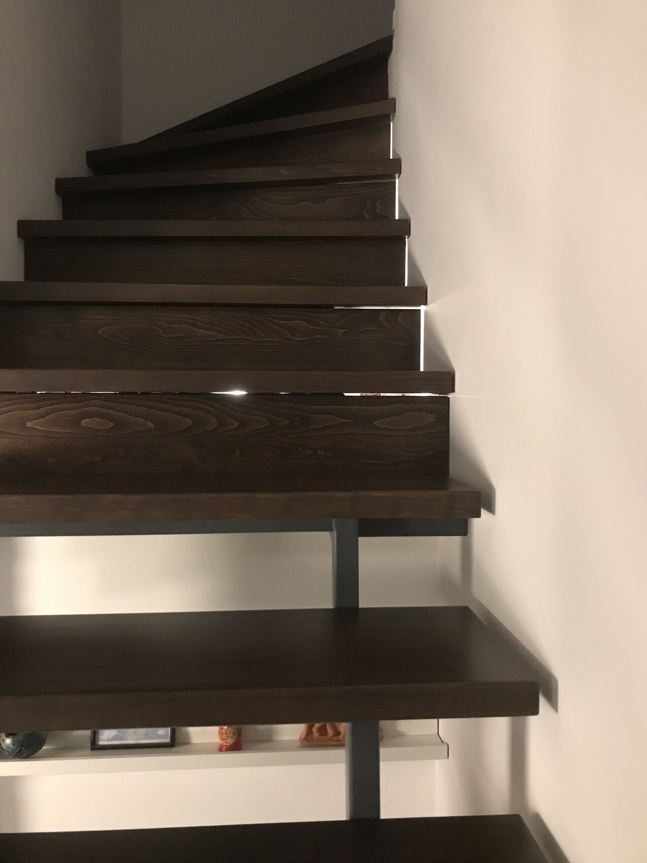

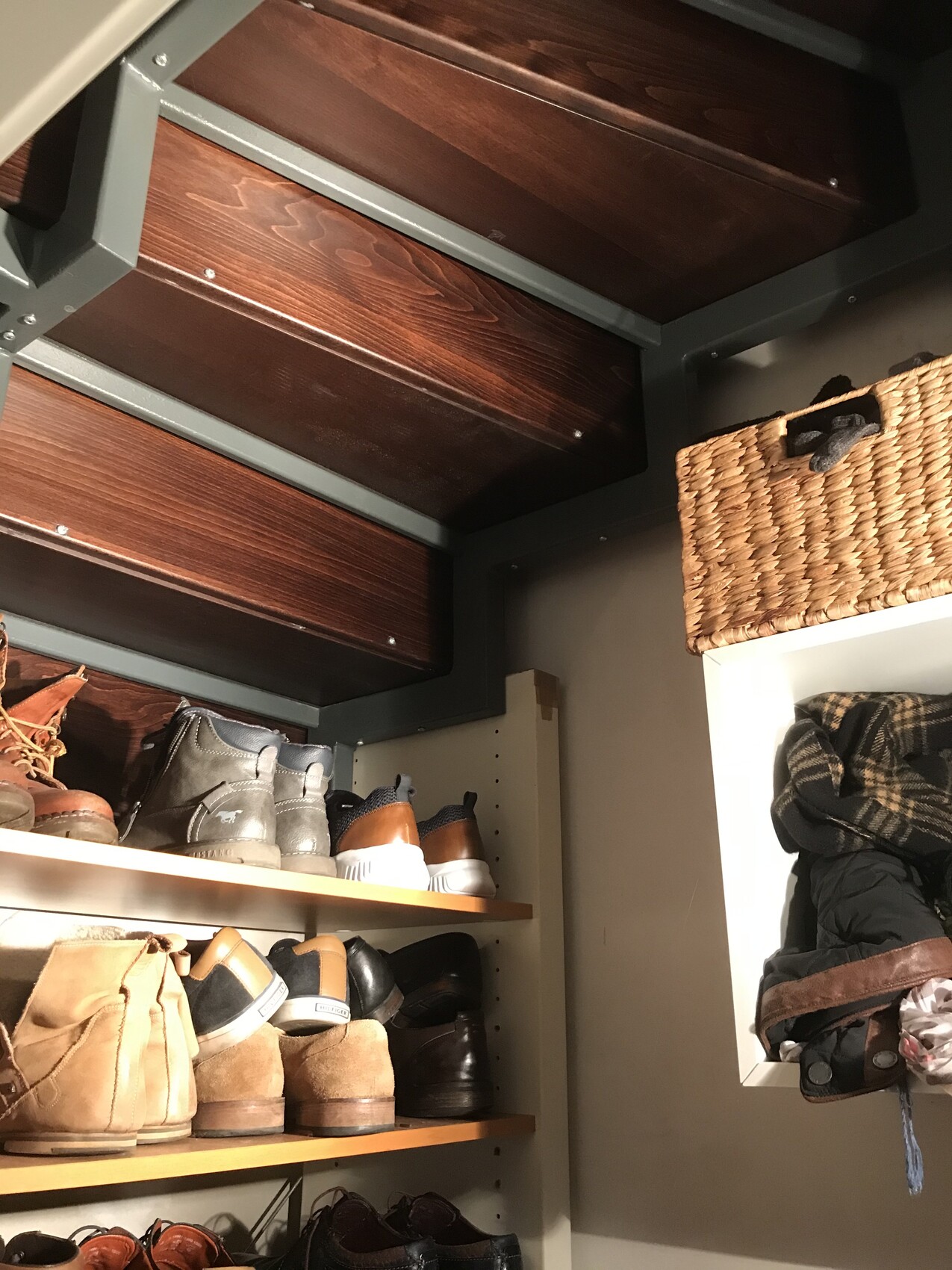

12 Nov 2020 23:49
This is how it looks on our side, once from the inside and once from the outside (the inside also clearly demonstrates the purpose of the chamber :p)
Modern dark wooden staircase in front of a light wall, taken from the side.
Open shoe rack with boots, casual shoes, and sneakers; basket in the top right corner and winter clothing.

This is how it looks for us, once from the inside, once from the outside (the inside also clearly shows the purpose of the cavity :p)
Now I understand the light issue 😀
Yes, let’s keep masonry as an alternative in mind. I think company 2 is reluctant to build it because a straight staircase would obviously require much more wall construction. With the landing staircase, it’s basically just the front around the door, the rest is solid anyway.
13 Nov 2020 00:06
In our case, only the wall below the risers is prefabricated panel construction; the rest is solid. We don’t have a stringer staircase, that’s the difference. With stringers, this shouldn’t happen, right?

In our case, only the wall below the risers is a panel construction; the rest is solid. We don’t have a stringer staircase, that’s the difference. Shouldn’t this kind of issue occur with stringers?
I’m not sure about that.
