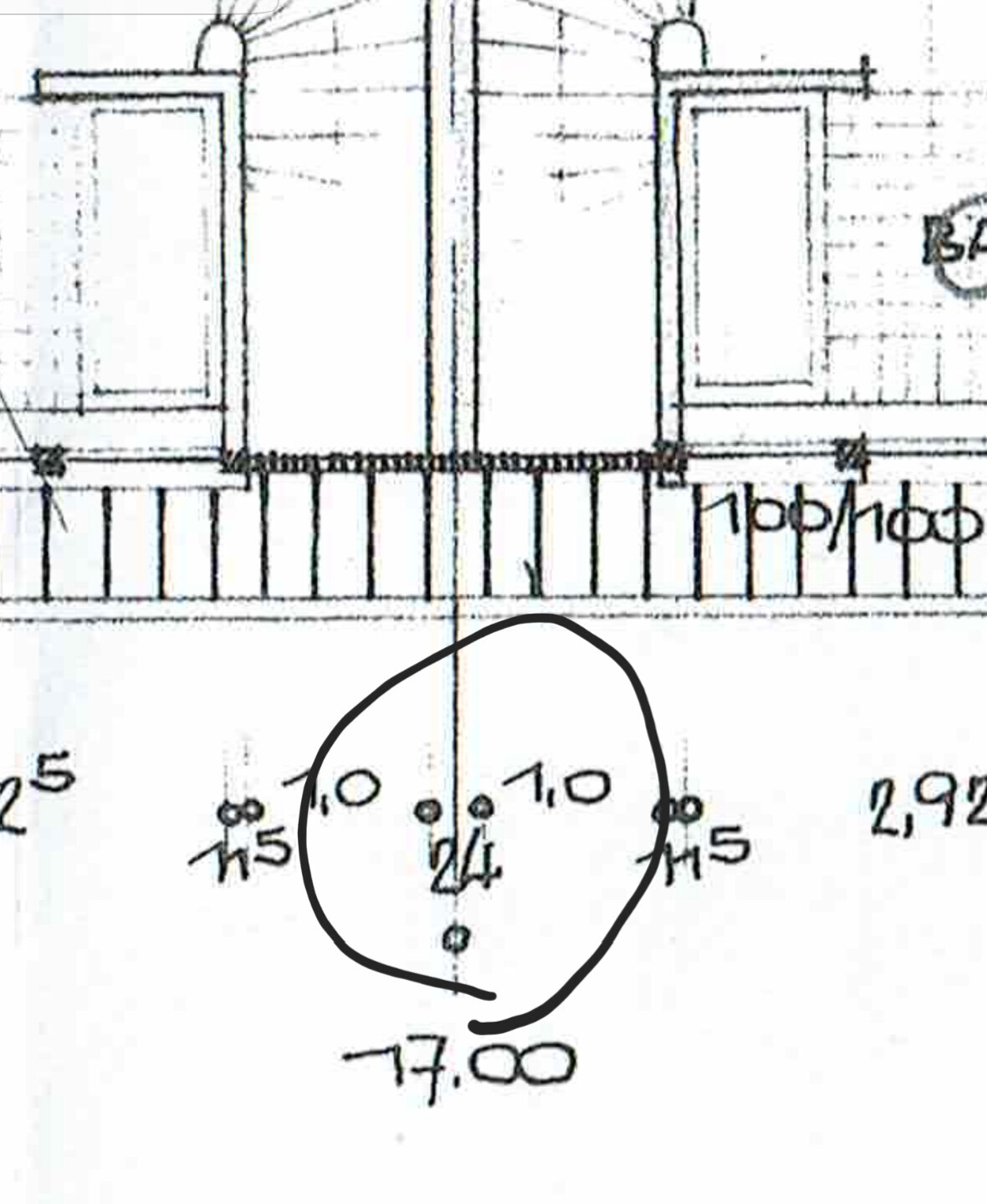

Unfortunately, this cannot be determined from the architectural plans.
Attached is an excerpt from the architectural and construction plans.
Two-dimensional floor plan drawing of a house plan with doors and dimension markings
