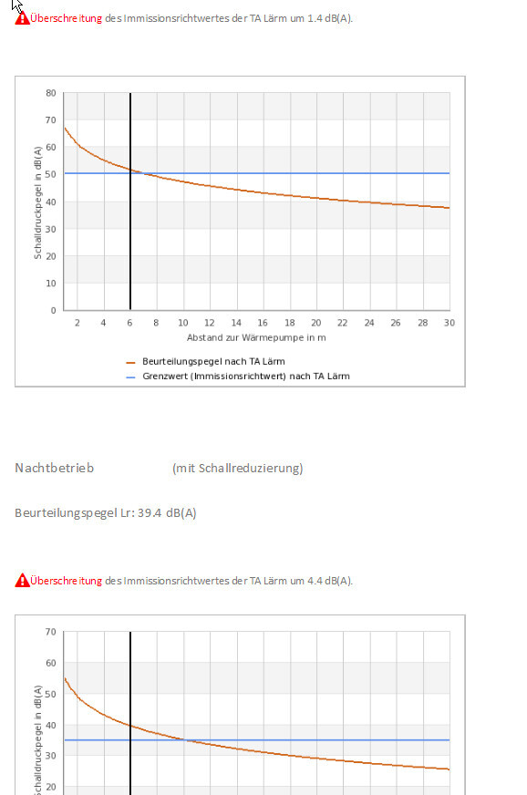

Caspar202024 Apr 2017 15:45AndreasPlü schrieb:
"4 m how is that possible?" Well, it can also be 4.5 m (15 feet), but no more, since it's a tightly built area and twice 2.5 m (8 feet) setback distances plus the distance to your own house wall can't be exceeded. Are there legal minimum distance requirements?First, you need to know where you are located:
Immission guideline value daytime (6:00 a.m. to 10:00 p.m.) Immission guideline value nighttime (10:00 p.m. to 6:00 a.m.)
6.1 Core, village, and mixed-use areas: 60 dB(A) / 45 dB(A)
6.1 General residential areas: 55 dB(A) / 40 dB(A)
6.1 Pure residential areas: 50 dB(A) / 35 dB(A)
6.1 Spa areas, hospitals, and care facilities: 45 dB(A) / 35 dB(A)
The value is measured
at built-up areas 0.5 m (2 inches) outside and in front of the center of the open window of the noise-exposed sensitive room (e.g., bedroom window);Which model does your neighbor have? There are quite a few differences. Then just look up the data sheet or the name of the unit.
One I know, for example, has 65 dB(A) during the day and 60 dB(A) at night. At a distance of 6.5 m (21 feet) (the measurement would be at 6 m (20 feet)), d
Depending on that, you can make sure your neighbor must at least do the following:
Outdoor units can be equipped with a sound insulation cover or be installed behind a noise barrier.There is a noise calculator on Wärmepumpe.de.
You can calculate it nicely, for example for the device mentioned above in a pure residential area.

This can be nicely calculated. At least 3 dB(A), preferably 6 dB(A), should be deducted from the immission guideline value. No single unit should be allowed to fully utilize the immission guideline values. First come, first served principle.
Otherwise, I find my opinion confirmed. With air source heat pumps designed and installed completely without restrictions, there will be major conflicts in the coming years.
