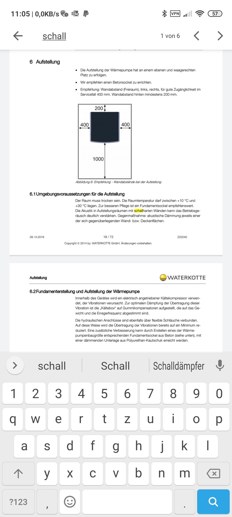

I would like to reduce the humming noise from our ground source heat pump in the utility room. This humming can be heard outside the utility room.
1) Should I better insulate the heat pump itself or the walls of the utility room?
2) Depending on the approach, which materials are suitable for sound insulation? I was thinking of Basotect foam?
Good luck, F
tomtom7927 Sep 2020 09:11
If you had read the installation manual once, you would see that it recommends installing a soundproofing mat on the opposite wall and behind the heat pump to reduce noise.
tomtom7927 Sep 2020 11:05
Can’t you take action yourself?
Heat pump: Diagram showing 400 mm (16 inches) clearance on the side, 200 mm (8 inches) above, 1000 mm (39 inches) free space in front

Thank you, @tomtom79.
