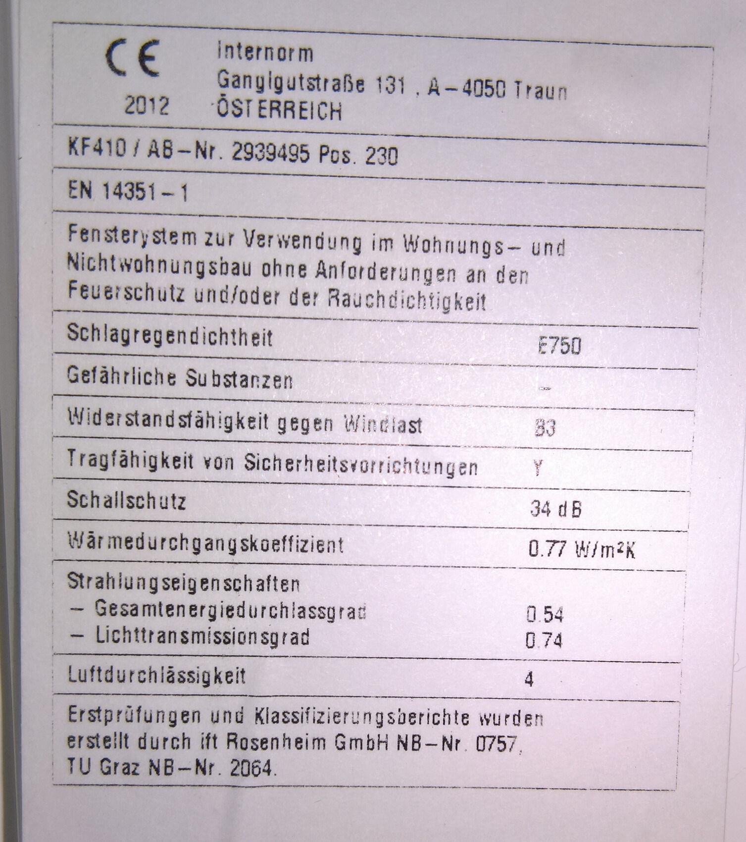

We have chosen Internorm windows KF 410 – on the website, the sound insulation value is listed as "34 to 45 dB," and for thermal insulation, it says "Uw up to 0.62." I’m a bit confused. Does this mean it reduces sound by 45 dB or not?
How exactly should this be understood?
On the delivered windows it says:
Sound insulation: 34 dB
Thermal transmittance (U-value): 0.77 W/m²K
It would be great if someone could provide some information 🙂

I had the chance to see one of the windows before installation and photographed the label:
DReffects schrieb:
What I just noticed is that there apparently isn’t an ILF 410 from Internorm.Perhaps a KF410 with integrated ventilation was meant (?)
