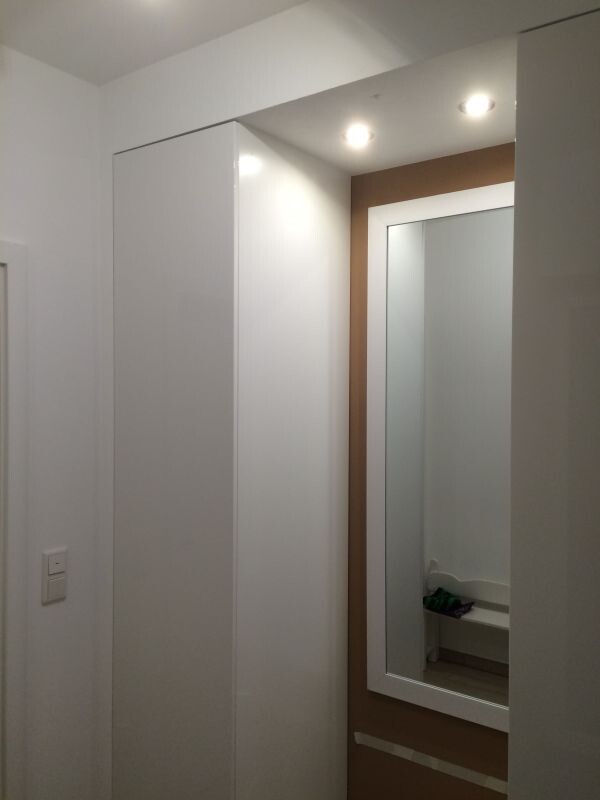

We designed our wardrobe using two 50cm (20-inch) wide Pax closets:
The surrounding area is covered with drywall and finished with the same quality plaster used throughout the rest of the hallway. The closet doors are flush with the surface. The two spotlights are controlled by a small motion sensor located above (visible if you look closely).
In the middle, there will be a wardrobe bench with a seat cushion, covering the full width and depth. The bench will also have drawers and compartments. The back third of the bench will open like a chest.
We deliberately chose not to have an open design. This way, everything is hidden inside the closets. The left closet has drawers, pull-out compartments, and a hanging rod. The right one features two hanging rods (one lower for the kids and another upper one for guests), plus storage shelves.
Sebastian795 Feb 2016 11:32I really like it – could you please take another photo showing the full width, and possibly with cabinets included? What is the width dimension?

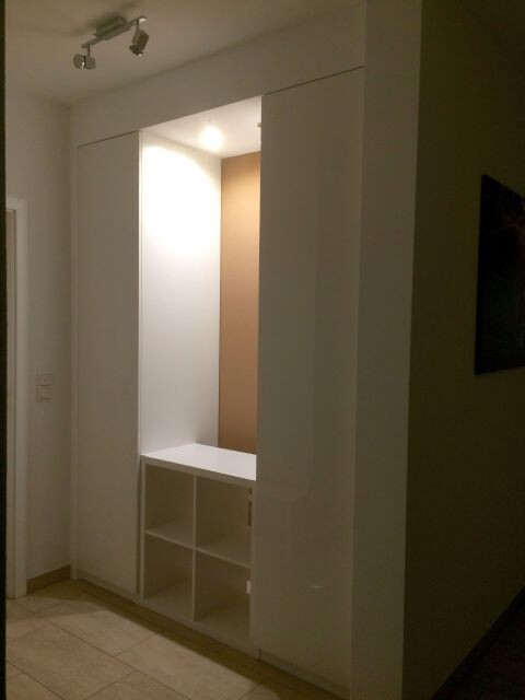

I can’t improve this much because I can’t move further back.
Here is what I can still offer:
However, the temporary shelf is still in place between the cabinets, which will be replaced by the bench. The mirror was installed the day after this photo was taken.
Layout:
5cm (2 inches) plaster + 50cm (20 inches) cabinet + 77cm (30 inches) bench + 50cm (20 inches) cabinet + 5cm (2 inches) plaster => total niche width: 1.87m (6 feet 2 inches)
Once everything is finished, I’m happy to share another photo.
Layout:

Sebastian795 Feb 2016 13:21My wife already wants a rebuild now – very good.
