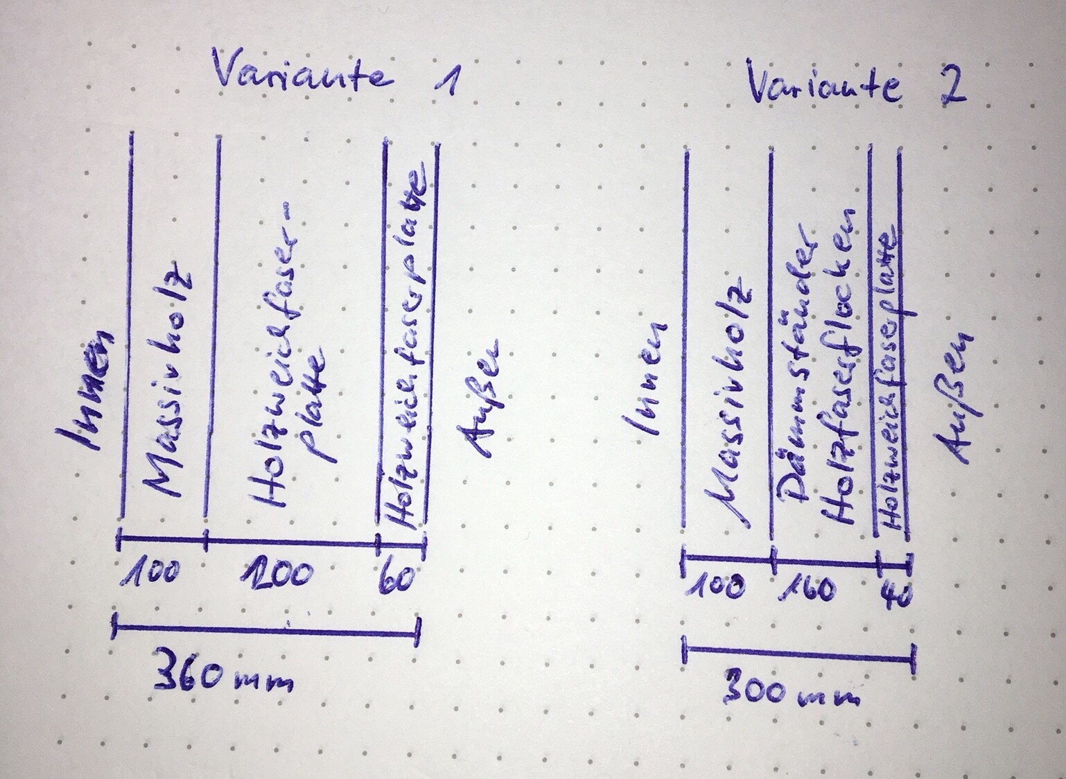

We have decided to build a solid timber house.
We now have several offers on hand;
Exterior wall option 1 (very expensive):
100mm solid wood
+ 200mm wood fiberboard
+ 60mm wood fiberboard
= 360mm (14 inches) wall thickness
The provider says this house stays cool and requires hardly any heating in winter.
Exterior wall option 2 (very economical):
100mm solid wood
+ 160mm stud cavity (blown with wood fiber insulation)
+ 40mm wood fiberboard
= 300mm (12 inches) wall thickness
Offered with air-to-water heat pump and underfloor heating
Exterior wall option 3: Lignotrend (mid-range price)
110mm cross-laminated timber ribs
+ chosen stud cavity width (blown with cellulose insulation)
Has anyone had experience with any of these construction methods?
Are there any experts here who would recommend one of these building techniques?
Thank you all

Bauherrin2018 schrieb:
100mm (4 inches) solid wood
+ 200mm (8 inches) wood fiberboard
+ 60mm (2.5 inches) wood fiberboard
= 360mm (14 inches) wall thickness And what kind of surface finishes are planned, or what else will be added on top of that?
And what will the surfaces be, or what else will be added?This is simply the wall structure – the question is whether it will be loose fill or board insulation?
Does the principle “more wall thickness = more insulation” also apply to wood fiber insulation?
This is simply the wall construction Exactly, at first glance only a 60mm (2.4 inches) difference – hence the question of how much this changes once plaster, brick veneer, or similar finishes are added.
