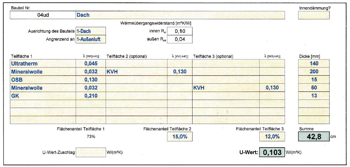

A ventilated air gap behind the roof covering would also be an important point.Hi, sorry. From the discussions with the architect and the building authority, I got confused and had incorrect figures and data in mind.
Here is the current roof construction from PHPP

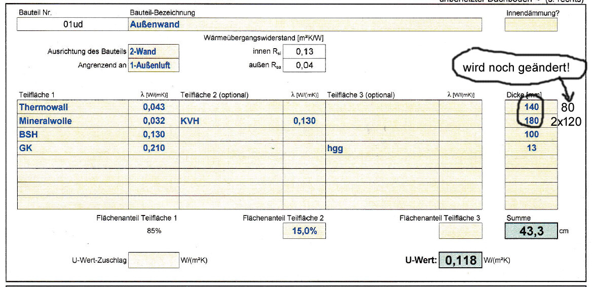

...An important factor in both options is of course the wall construction. In this solid wood house, the wooden wall thickness is 200mm (8 inches) plus 120mm (5 inches) wood fiber insulation boards. Alternatively, we could also consider a 240mm (9.5 inches) thick wooden wall. This should, of course, help with sound and heat insulation.That seems like a very high proportion of wood. What is the total thickness of the wall construction? I would be very interested in the exact wall build-up!
Our wall is “only” 10cm (4 inches) Glued Laminated Timber and has a total thickness of 44cm (17 inches). With this and other measures, we achieve KfW40(+).
