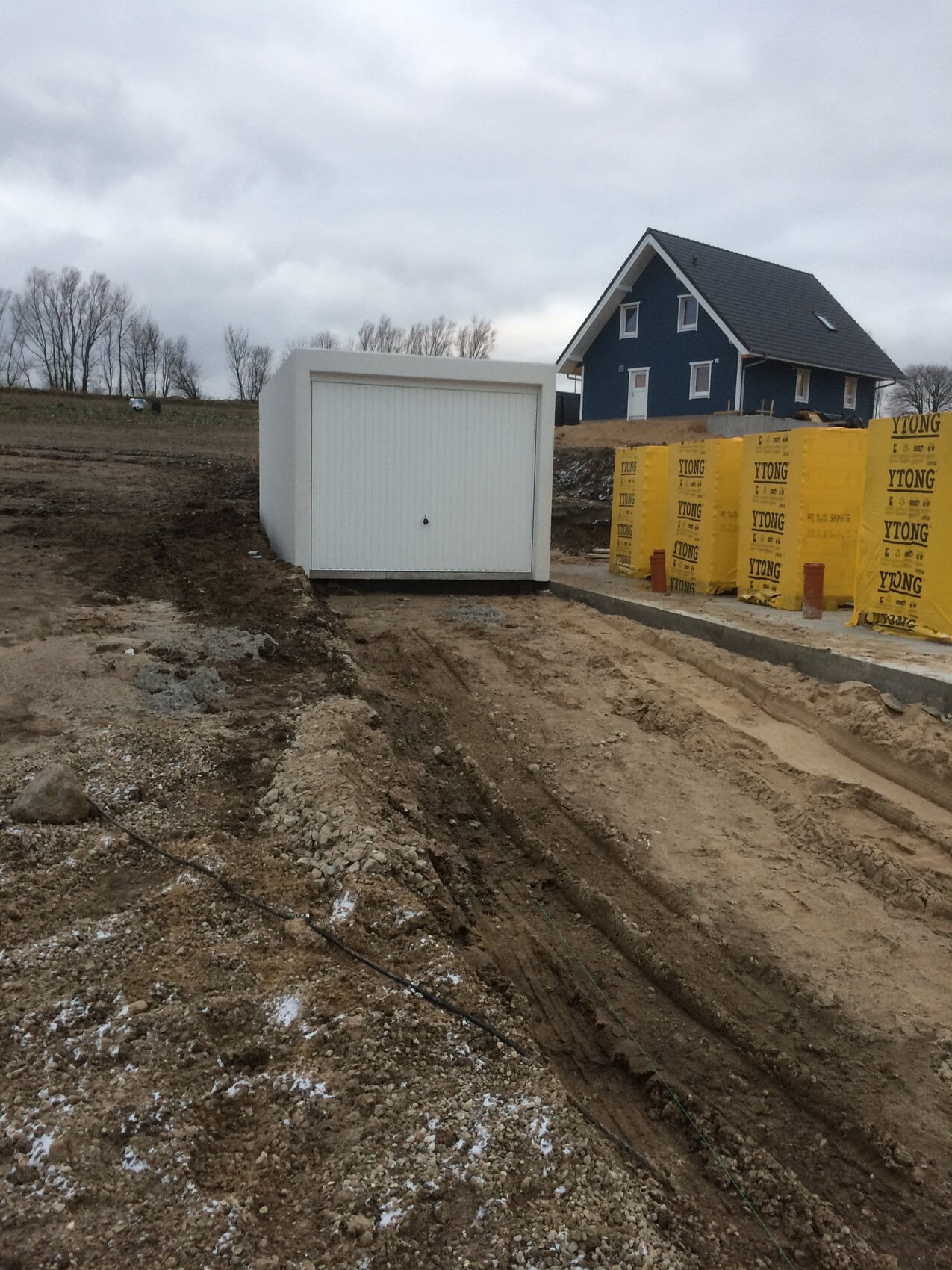

I live in Ytong blocks without external thermal insulation composite systems (ETICS). And that is fine. Dry, warm, and cost-effective. Also, drilling into the walls works well.
Note: This is not a statement claiming that living in Poroton would be worse. I would let sympathy for the company and price decide.
