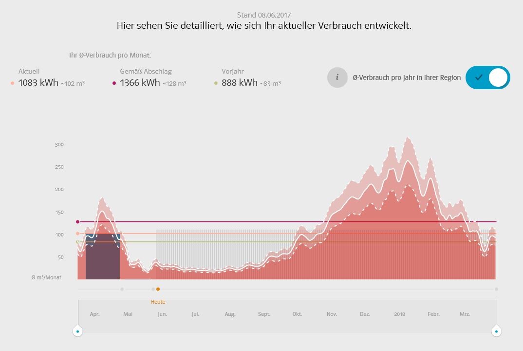

Here, as an example, 1000 liters and 14 m² (150 ft²). From the end of April until now, mid-June, 1 m³ (35 ft³) of gas per week during a week of continuous rain (first graphic).
The fact that all the "not worth it" cases might actually, possibly, under certain circumstances, be worth it can be seen in the second graphic.
It is clear from the numbers that this is not a 100 m² (1,076 ft²) house; much more interesting is the comparison to similar households.
