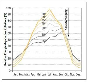

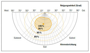

Micha In winter, the system won’t be much help for hot water or heating. It’s a nice bonus, but the benefits are mostly noticeable in summer and the transitional seasons. November, December, and January... you won’t get much out of a solar thermal system alone during those months.
I have some charts about orientation and tilt angles — let me see if I can upload them, they’re quite interesting.
