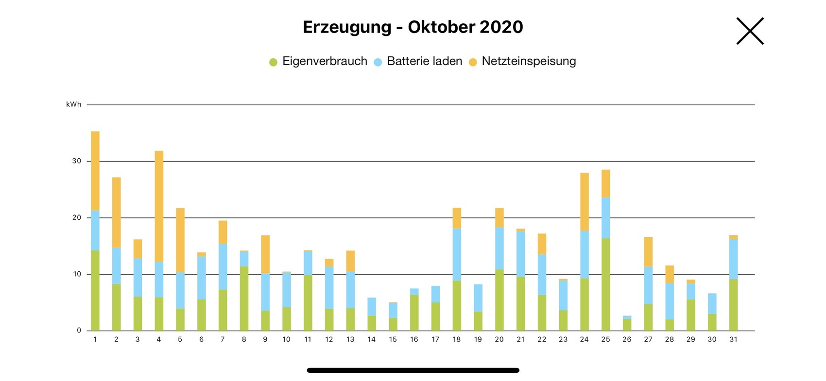

With my storage system, I haven’t had to buy any electricity from early April to the end of October. My supplier must be happy about that. Please show your log. I’d be interested to see it. Around Nuremberg (and that’s definitely not Hamburg) October was really bad. Since early October, I haven’t managed to fully charge the battery 10 times.

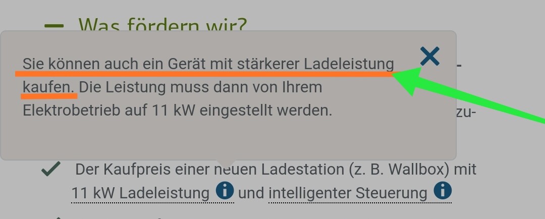

Bookstar schrieb:
There are also restrictions, for example, you may only be allowed to charge at 11 kW.That’s true, but after the subsidy, it might be possible to increase the power later on.
