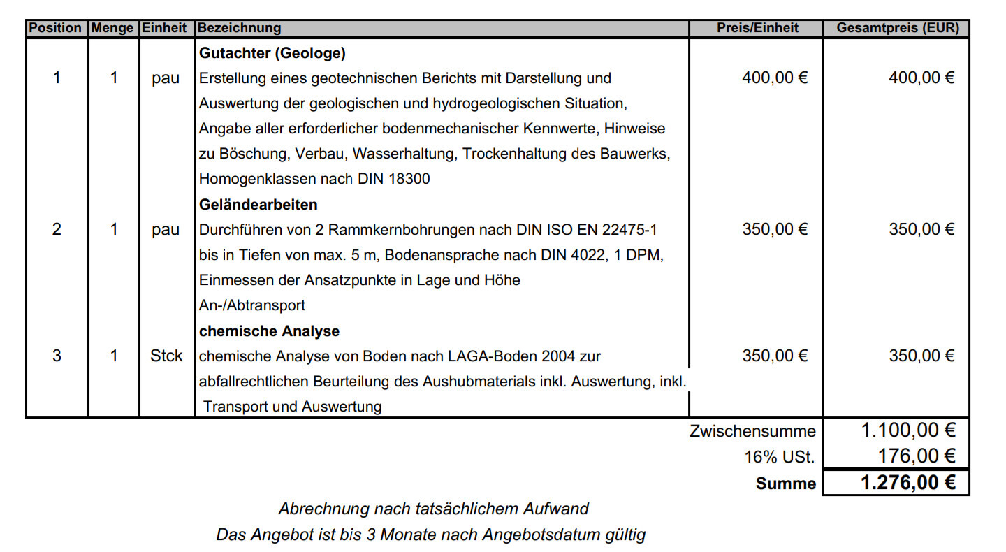

3.) See attachment
Angebot/Rechnung: Positionen Geotechnik, Erdarbeiten, chemische Analyse; Gesamt 1.276 €

5 Jul 2020 20:45
Offer 2 is the most affordable.
Offer 1 tests the infiltration capacity of the ground for 75 euros. This is not listed separately in the other two offers.
