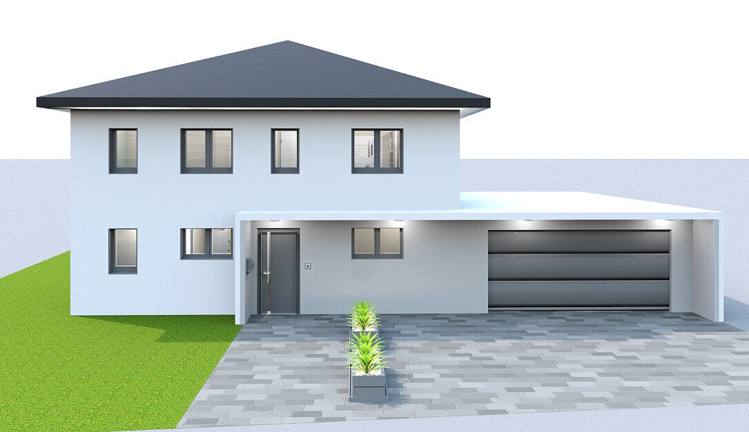

Roofs can also be created in Sweet Home 3D, but it is a bit more complicated since the software does not really support this feature by default. However, you can find many downloadable elements for interior and exterior use on various websites, and with some practice, you can design the exterior of your house. I have also seen examples online with different terrain heights, but I am still not quite familiar with that myself. To be honest, exterior visualization is partly only possible with some fiddling, I must admit 😉.
Even if this program might not be the right choice for you, @TE, I just wanted to mention it briefly here. Unfortunately, I don’t have a recommendation for a more suitable program.
I am attaching a screenshot from Sweet Home that I created.
