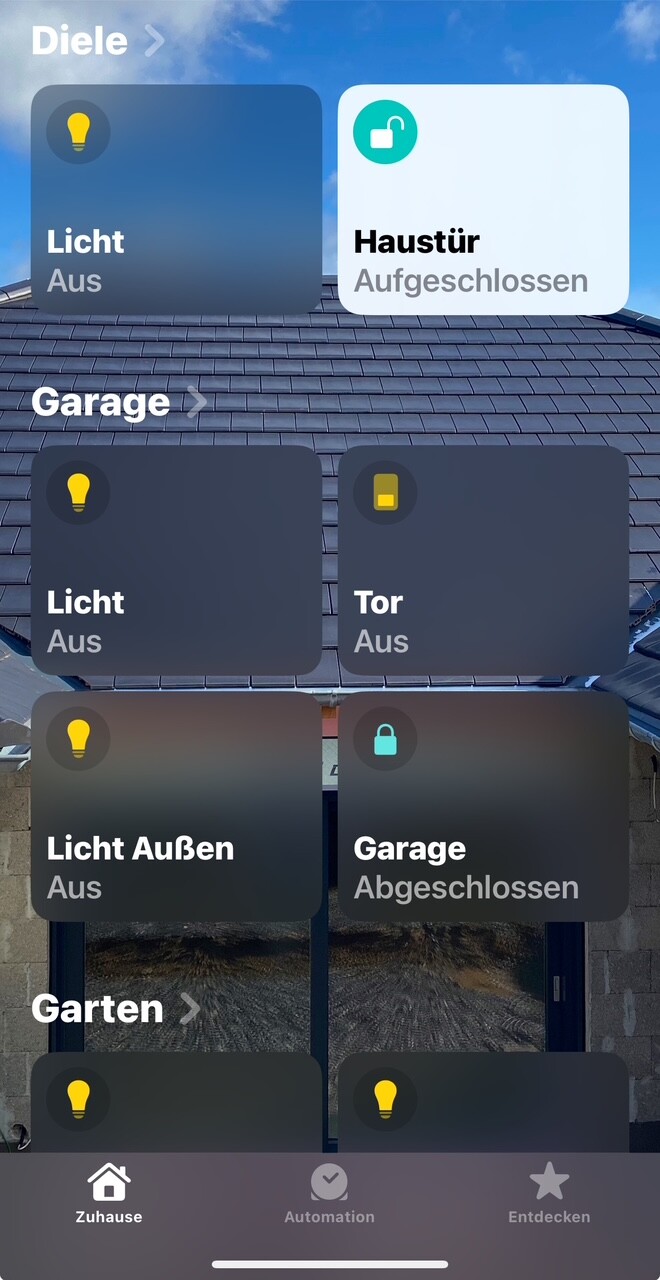

Does it work like this—you have your phone with you and say to “it”: “Open the door!”? Yes, it doesn’t matter whether it’s the phone or the watch. I find it hard to get more convenient than this.
In the app, you can also see the exact status of the lock. Here, for example, the hallway and garage.
My explanations are only this detailed because I was asked.
